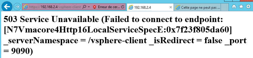

    I have no way to access anymore our VMware console https://192.168.2.4/vsphere-client/
    It reports the following error :
    503 Service Unavailable (Failed to connect to endpoint: [N7Vmacore4Http16LocalServiceSpecE:0x7f23f805da60] _serverNamespace = /vsphere-client _isRedirect = false _port = 9090)
    Unfortunately, windows websphere client also doesn't work anymore and we really need to start a windows virtual machine located on it.

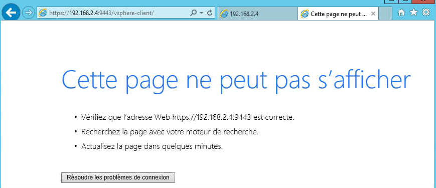

    Posted Jul 05, 2017 08:48 PM
    If I try to access https://192.168.2.4:9443/vsphere-client/​ it reports a Can't display error page :

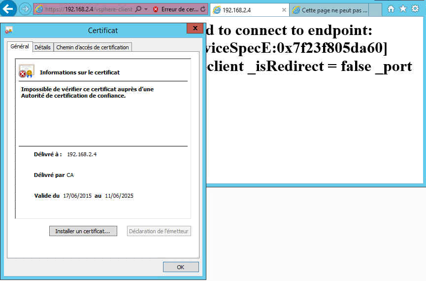

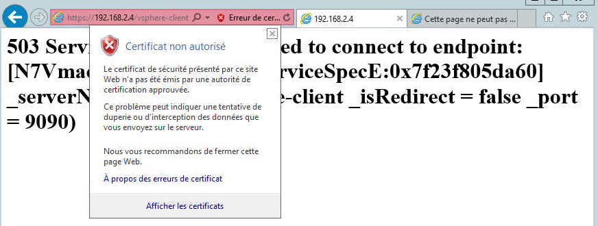

    Posted Jul 05, 2017 08:56 PM
    Now, I just noticed https://192.168.2.4/vsphere-client actually reports a certificate error :
    It says Unallowed Certificate : (unapproved authority)
    When I display Certificate I get this :
    I just tried installing the Certificate... unfortunately, error remains exactly the same trying to access https://192.168.2.4/vsphere-client
  • 11.  RE: vsphere - service Unavailable
    Posted Jul 07, 2017 07:03 AM
    Yes, this is certificate error, you need to dig up logs more. Please see step 4 and 5 in "503 service unavailable" error when connecting to vSphere Web Client (2121043) | VMware KB
