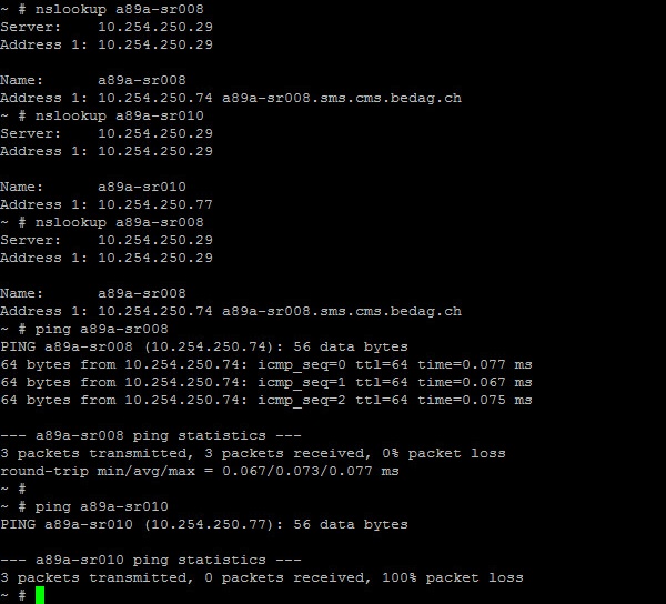

    Hi ... you are right.. pinging the other host is not possible.. confuses me.. do you have a clue why i can't ping?
    They are in the same Subnet...

    Only a guess. Please double check DNS resolves the names properly, e.g. no typo in the Host-A DNS entries.
    André
  • 5.  RE: vSphere HA detected that this host is in a different network than the master to which vCenter Server is connected
    Posted Oct 25, 2012 05:16 PM
    DNS seems to work properly
