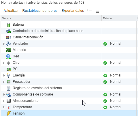

    This also seemed to somewhat correct the problem for me. I see sensor data now, but hardware events don't appear to trigger a sensor change. I'm going to do some more testing on this to verify.
    Also noted the following:
    1. 2 of the 3 PowerEdge R910 servers show the Serial number shows up as: "null" & the Tag field shows up with a super long GUID looking alpha-numeric string--there is no Asset Tag field. The 3rd PE R910 does show the Serial Number field with the proper DELL Service Tag, Tag field still shows the GUID number, and the Asset Tag field says "unknown". Due to them all being R910s I'm suspect the disparity is because of a differing firmware of the Lifecycle controller or other subsystem.
    2. Both our PowerEdge R820s show the Serial Number field with the proper DELL Service Tag, Tag field shows the GUID number, and the Asset Tag field says "unknown".
    3. Our PowerEdge R830 show the Serial number as: "null" & the Tag field shows up with the GUID looking alpha-numeric string--there is no Asset Tag field.

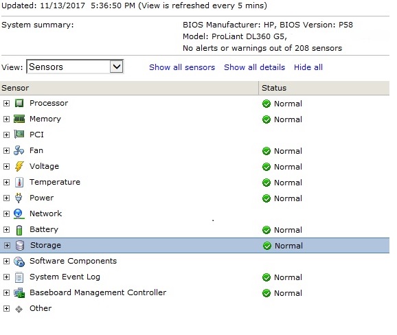

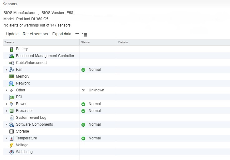

    We are running HP Proliant DL360 gen 8 and gen 9. After upgrading, the sensor work, but I'm seeing way less sensors than with 6.0. For example, in 6.0 you saw the individual memory banks. Now with 6.5 it only display total memory, not individual banks. Also, some sensors in the tree even don't expand when you click on them.
  • 19.  RE: vSphere ESXi 6.5.0 Hardware Sensors
    Posted May 15, 2017 01:40 PM
    "Also, some sensors in the tree even don't expand when you click on them"
    Click on the expand all link in the list that starts "Update Reset Sensors ...", it looks like a little black triangle with four lines next to it.

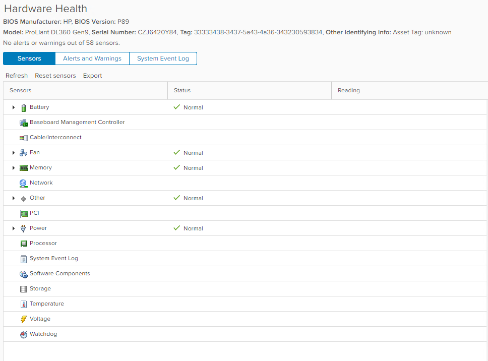

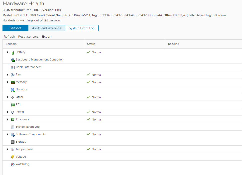

    Posted Jun 01, 2017 03:46 PM
    We also have a HP DL360 GEN 9 running ESXi 6.5. Same issue with sensors . I have opened a case with VMware and HP. HP claims that since they can see the hardware properly through iLO it is an OS issue.
    VMware is still reviewing the issue. They have pulled system logs from my system. and are supposed to get back with me by next Monday.
    At this point that have acknowledge that it is something "new" but not sure if it is a bug or just something specific with my system
    Things I have tested, still on showing 79 sensors
    • HP 6.5  customized image Nov2017 Install
    • HP 6.5  customized image May2017 Install
    • Latest 6.5 Image install , with Feb2017 Offline Bundle from HP , Including util bundle, and AMS bundling
    • HP 6.0  U3 customized image Feb2017 Install ( 200+ sensors showed up)
    Current build in production environment
    • HP DL360 GEN 9, HPE-ESXi-6.0.0-Update2-iso-600.9.5.0.48 , VMware ESXi, 6.0.0, 3620759 ( 526 Sensors ) Showing.

  • 21.  RE: vSphere ESXi 6.5.0 Hardware Sensors
    Posted Jun 13, 2017 01:21 PM
    We also experiencing this issue on HP DL360 GEN8 and GEN9 running ESXi 6.5 HP 6.5  customized image May 2017
    Before the update (running HPE-ESXi-6.0.0-Update2) there are 192 sensors visible. After the update only 58 sensors are visible (see screenshots).
    Did you get a response from VMWare?
  • 22.  RE: vSphere ESXi 6.5.0 Hardware Sensors
    Posted Jun 13, 2017 01:25 PM
    No update at this time, They have identified it as a bug and I have been told they are working on it.
    I have not received any information on whether there will be a fix prior to the next update or not. I was told it is a bug with the CIM service
    I will press for an update today. I am mildly annoyed that they don't have a place to list the bugs they are working on .
    Thanks,

    There is a problem displaying the sensors in VCSA 6.5 received from the host esxi 5.5, VCSA 5.5 information sensors 208 is shown in detail sensors and VCSA 6.5 only 147 sensors ! esxi 5.5 installed on the HP ProLiant DL360 G5, anyone has this problem ?
  • 34.  RE: vSphere ESXi 6.5.0 Hardware Sensors
    Posted Dec 08, 2017 02:27 PM
    Hello i have the same Problem:
    VCSA 6.5 won't display the HP DL380 G5 storage status the esxi Client 5.5 display the storage status.
    Did you open a support case?

    Hi!
    We are experiencing the same problem when we upgrade from ESXi 5.5 to 6.5. Our hosts are HP Blade BL460c. We see 163 sensors in ESXi 5.5 but just only 51 in 6.5 :smileysad:
    We wonder if someone has found a solution to this issue.
    Thank you very much!! Any help will be appreciated.
  • 39.  RE: vSphere ESXi 6.5.0 Hardware Sensors
    Posted Mar 15, 2018 01:24 PM
    As indicated in this https://kb.vmware.com/kb/2151238 article, they've purposely removed every sensor there that doesn't report a health state. They have moved or will be moving that data to elsewhere in the UI.
  • 40.  RE: vSphere ESXi 6.5.0 Hardware Sensors
    Posted Mar 15, 2018 01:41 PM
    Thank you very much jsprinkleISG for your response.
    You are right, we can see the sensors if we open the UI of the host (not via vCenter). But we see only a few of them (55):
    Nevertheless, in the previous version we can see much more sensors (163).
    Regards,
