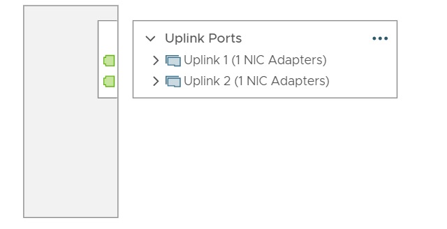

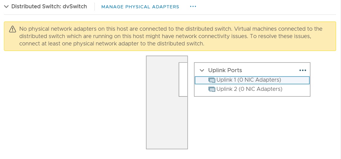

    With all VMs migrated to a standard switch and host removed and then added to dvSwitch the error didn't come up.
    The error comes back as soon as we add physical adapters to the uplink ports
