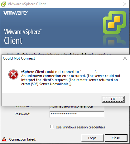

    Hi all!
    I'm having trouble not able to connect to vCenter from vSphere
    Server error: 503 Server Unavailable
    What do I need to do to remedy the above situation
    If you have any idea about fixing this, please help me.
    Thanks

    I am using vcenter version 6.0. VCenter installed as a server appliance on OS SUSE Linux Enterprise 11.
    If I try to access vcenter via website, I get this message

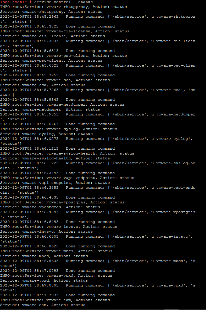

    connect to vcenter by ssh and check the services: ( the next command was runned on a vcsa 6.5)
    service-control –status
    Running:
    applmgmt lwsmd pschealth vmafdd vmcad vmdird vmdnsd vmonapi vmware-cis-license vmware-cm vmware-content-library vmware-eam vmware-perfcharts vmware-psc-client vmware-rhttpproxy vmware-sca vmware-sps vmware-statsmonitor vmware-sts-idmd vmware-stsd vmware-updatemgr vmware-vapi-endpoint vmware-vmon vmware-vpostgres vmware-vpxd vmware-vpxd-svcs vmware-vsan-health vmware-vsm vsphere-client vsphere-ui
    Stopped:
    vmcam vmware-imagebuilder vmware-mbcs vmware-netdumper vmware-rbd-watchdog vmware-vcha
    more info
    https://kb.vmware.com/s/article/2109887?lang=en_us
    tell us what the command shows,

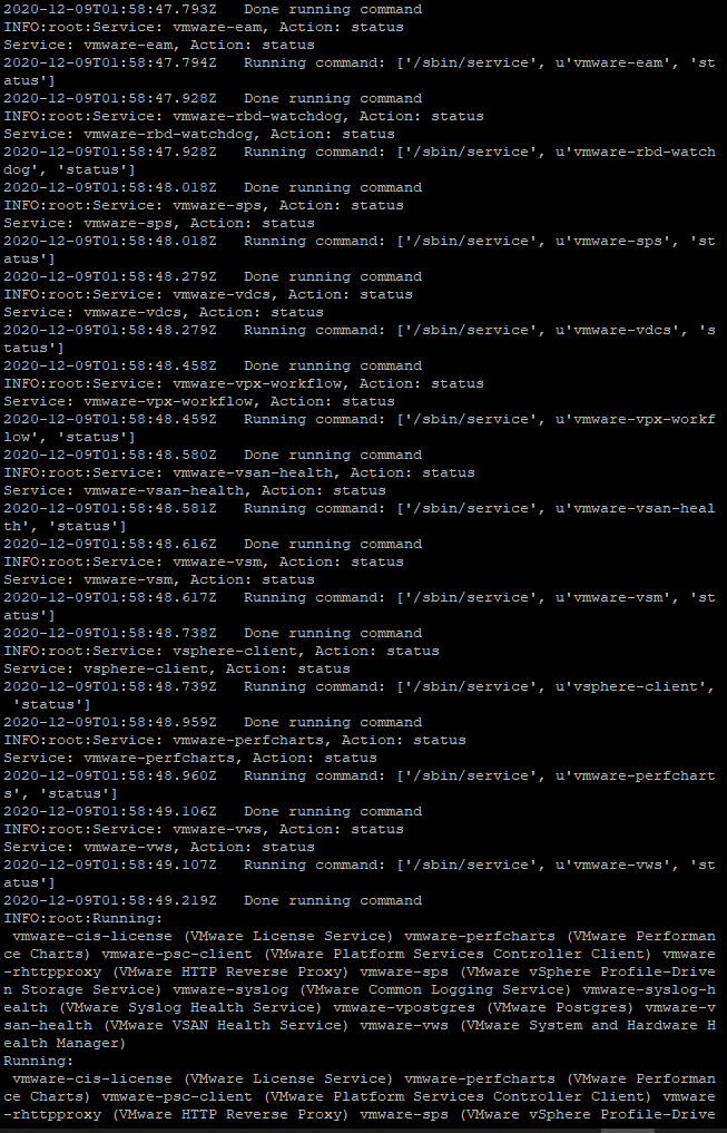

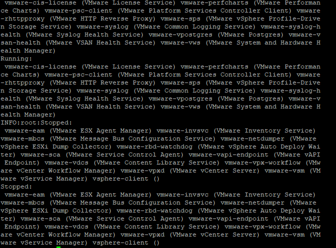

    This is what shows up when I run the command
  • 6.  RE: vSphere Client could not to connect to vCenter
    Posted Dec 09, 2020 09:56 AM
     It looks like the vmware-vpxd next to a couple other important services are not running. So it makes sense you cannot connect to the vCenter Server.
    Can you have a look in the vpxd.log file as to why the service is not running?
  • 7.  RE: vSphere Client could not to connect to vCenter
    Broadcom Employee
    Posted Dec 30, 2020 03:54 AM
    invsvc, vapi,  vpxd down. Could be a solution user cert issue.
    Run service-control --start --all   and post the output of the service log that fails.
