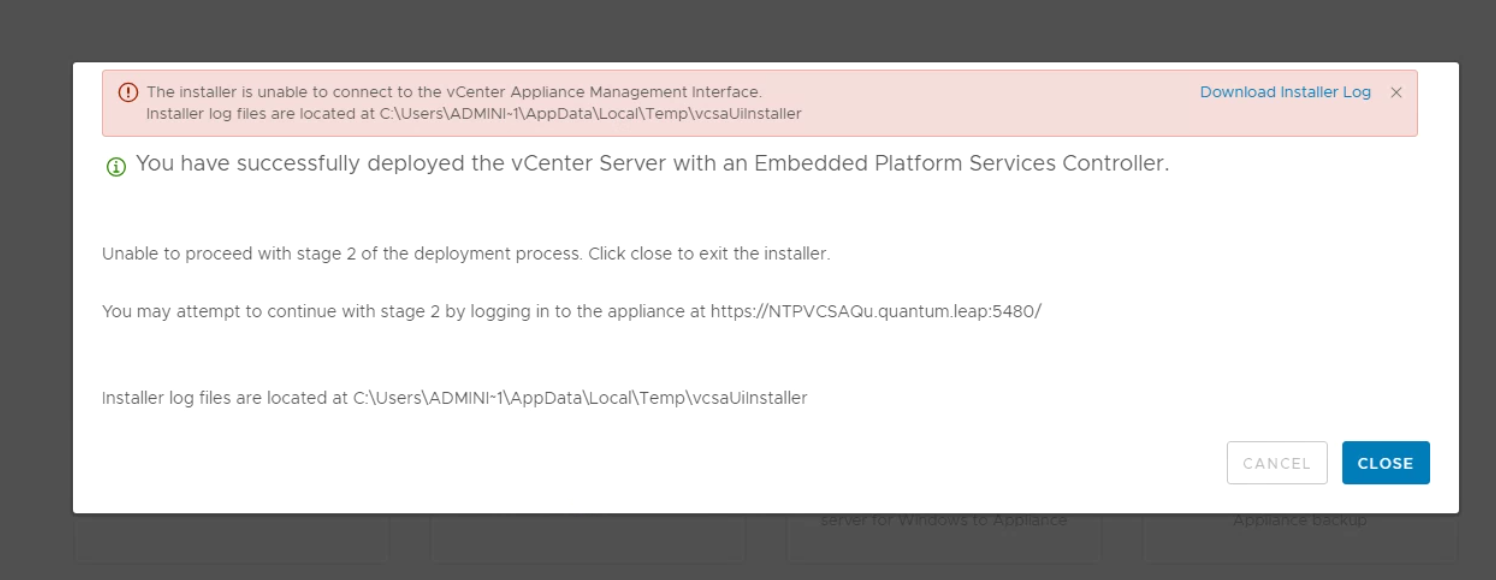

  • 10.  RE: vsphere 6.7 Vcenter Server Appliance 7.0
    Posted Dec 30, 2020 09:39 PM
    this is the error I got in stage 1
  • 11.  RE: vsphere 6.7 Vcenter Server Appliance 7.0
    Posted Dec 30, 2020 10:46 PM
    A couple of things:
    1. Do not use a FQDN with mixed cases. Use all lower case, always, everywhere.
    2. You need both A and PTR records to exist which correspond to the hostname for vCenter *before* you begin the installation process. This must exist in local DNS. Have you done this?
    3. Please just paste screenshots in and keep responses in a single post as much as possible. We don't like to download attachments and scroll to read single-sentence replies.
