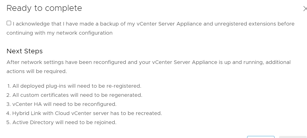

    I have Vshpere installed on a Vcenter server. I made a DNS change using the Vcenter and I couldn't start the Vshpere client anymore.
    Does anyone know what is causing the error?
    1- First I changed the DNS.
    2- Then this appears.

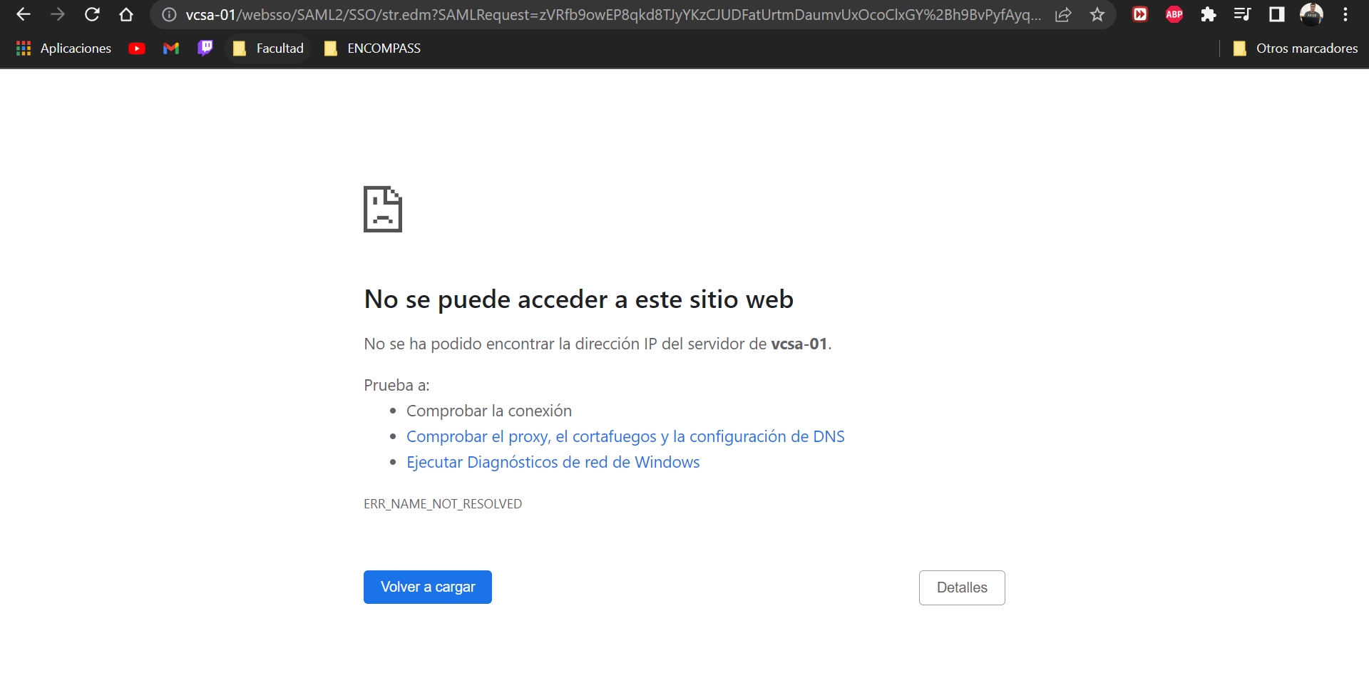

    3-I put "agree" and "next". And after wait a few time, i try to use the vshpere and...
    somewone knows how can i fix this?

    Not full information you provided.
    Have you changed the DNS entry on the Domain controller?
    Check with nslookup command what will be the answer. If the problem was only there you are lucky boy.

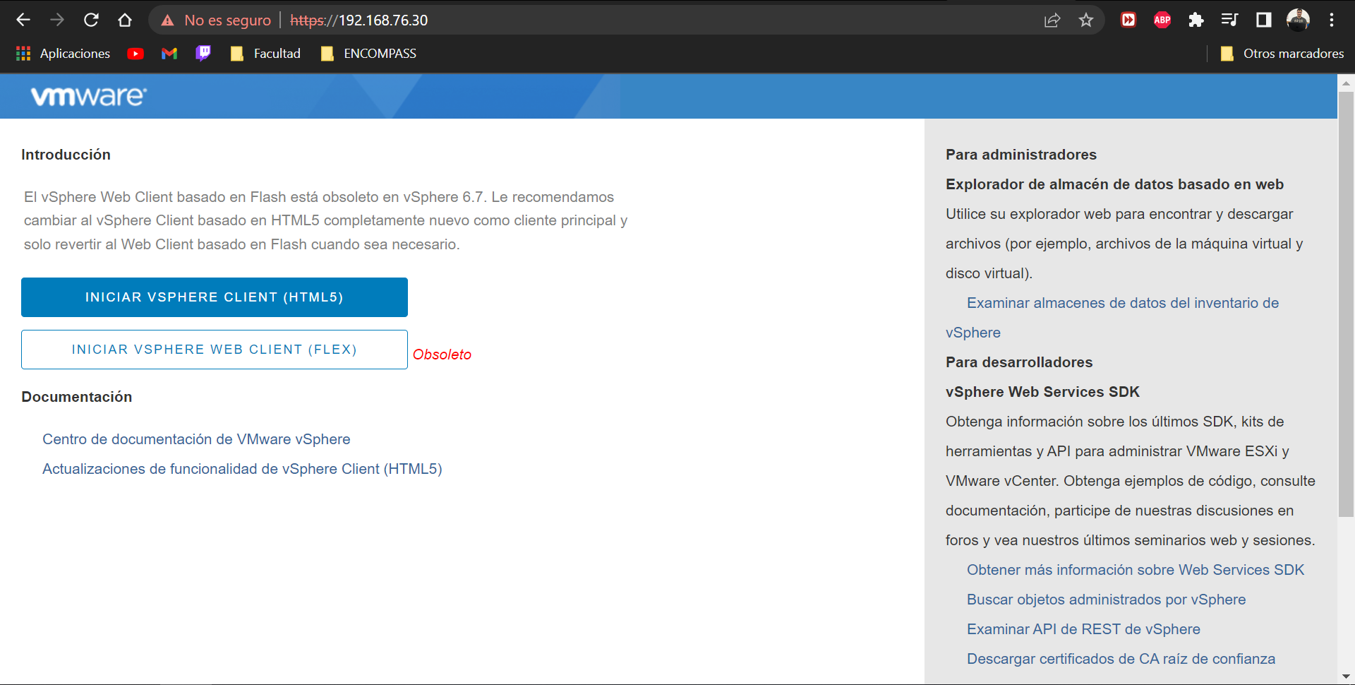

    Can you access it via IP? If so can you try use the cli to try dns lookups to see what is failing?
