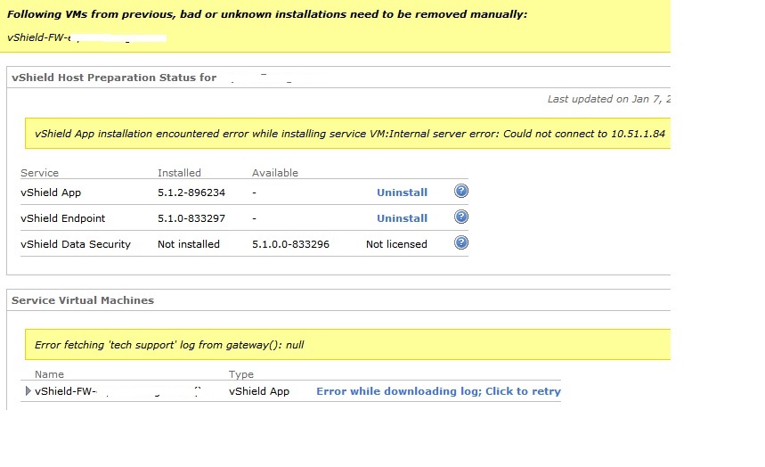

    I keep getting an error wwhen installing vshield app. I tried this link no still an error
    VMware KB: Installing VMware vShield App fails with the error: Previous installation of host services encountered an…

  • 3.  RE: vshield app installation encountered an error
    Posted Dec 23, 2013 02:11 AM
    here
  • 4.  RE: vshield app installation encountered an error
    Posted Dec 23, 2013 03:02 AM
    May be because of this?
    vShield App install fails in a scenario where one of the hosts is not the part of dvSwitch
    vShield service virtual machines install can fail in certain scenarios. Consider a scenario where there are two DRS-enabled clusters in a datacenter and each cluster has two hosts. You create a dvSwitch and add one host from each cluster into the dvSwitch successfully. Now if you deploy a new virtual machine or install vShield Edge with its vnic in the port group of the above created dvSwitch, the virtual machine is not created and the OVF file is not imported.
    Workaround: If DRS is enabled, you must add at least two hosts from the same cluster in a dvSwitch.
  • 5.  RE: vshield app installation encountered an error
    Posted Dec 23, 2013 07:58 PM
    all 3 hosts in the cluster are on the dvswitches. I am having issues with the vapp install on this one host. vshield installed fine. All hosts are running on the same build number
  • 6.  RE: vshield app installation encountered an error
    Posted Jan 07, 2014 12:32 AM
    i cant figure it out. I removed the host from the existing cluster, reinstalled, the host, readded back into the the cluster but the vapp installation error is still there. looks like vshield manager cannot communicate with this vapp. But I went to vshield manager and was able to reach this vapp machine. tried to download the support log and got error too
