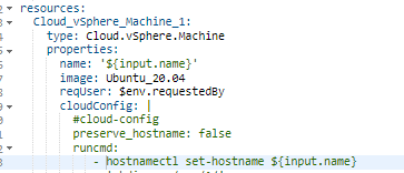

    I apologize if this has been asked and resolved before. I am trying to get Cloud-init to work with vRA8.6 in order to execute a hostname change for a Ubuntu 20.04 image. But I am unable to get this work, I have seen many different post from different people reporting this issue. One blog seems to report this a known issue and there is some "workaround" in place but the blog post has some age and I was wondering if there is a fix or someone is aware of something else?

    Blueprint is simple, I've tried different other runcmd commands just in case the set hostname was the issue but nothing works. Any suggestions?

    Did you checked if your cloud config is following the yaml rules ?
    Looks i see more then 2 spaces after the runcmd.
    Its know for erroring out on yaml mistakes.
