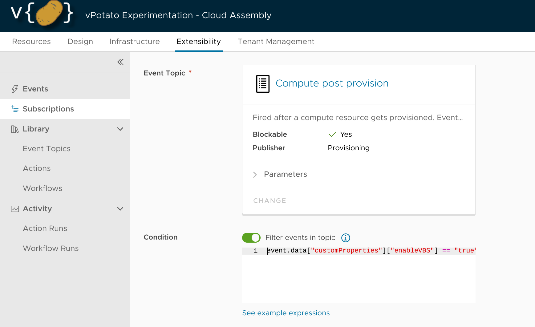

    I think the easiest approach would be to put a filter directly on the subscription in Cloud Assembly. Something like this should do the trick:
    https://www.virtual-allan.com/vmware-vra-8-subscriptions-and-advanced-condition-filters/

    Posted Apr 12, 2022 01:26 PM
    Yep. You'd put a boolean input on the request form, bind it to a customProperty on the resource, and then set a filter on the subscription so that it will only call the vRO workflow if the boolean is true.
    So something like this in the Cloud Assembly template:
    inputs:
      enableVBS:
        type: boolean
        title: Enable VBS
    resources:
      VM_1:
        type: Cloud.vSphere.Machine
        properties:
          enableVBS: ${input.enableVBS}
    And you could put something like this in the condition filter when creating the subscription:
    event.data["customProperties"]["enableVBS"] == "true"
    Alternatively, put a check for that boolean at the top of the script in the vRO workflow:
