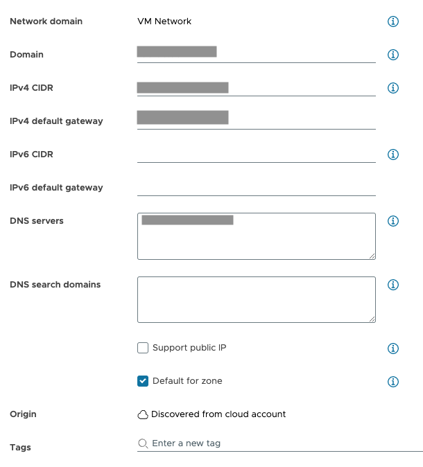

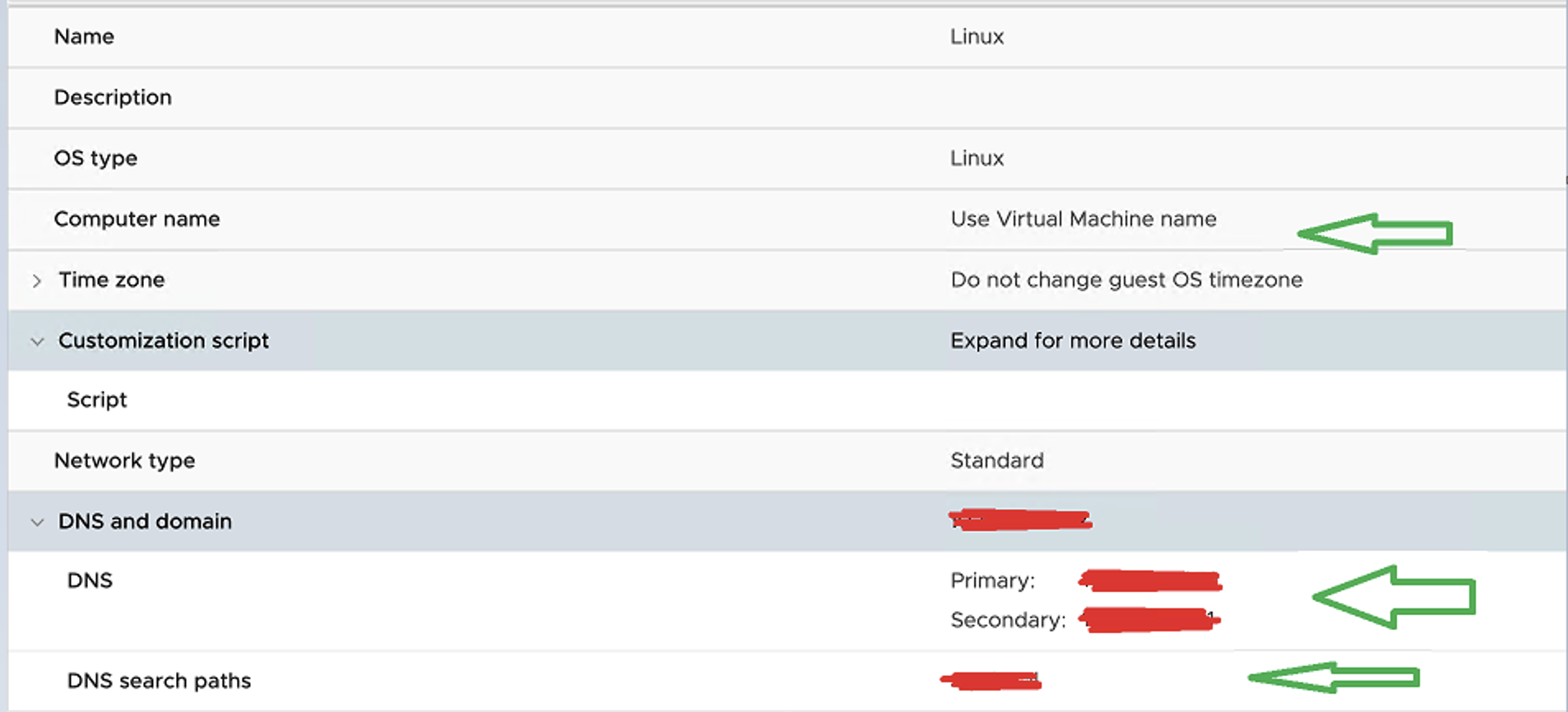

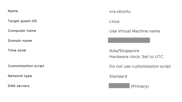

     Yes, I've configured IP Ranges, AD integration validated successfully. vmtool installed in the ubuntu vm template too. Below is my configuration for customspec and network profile. A little different from yours. If you need more info let me know, I can pm you privately.

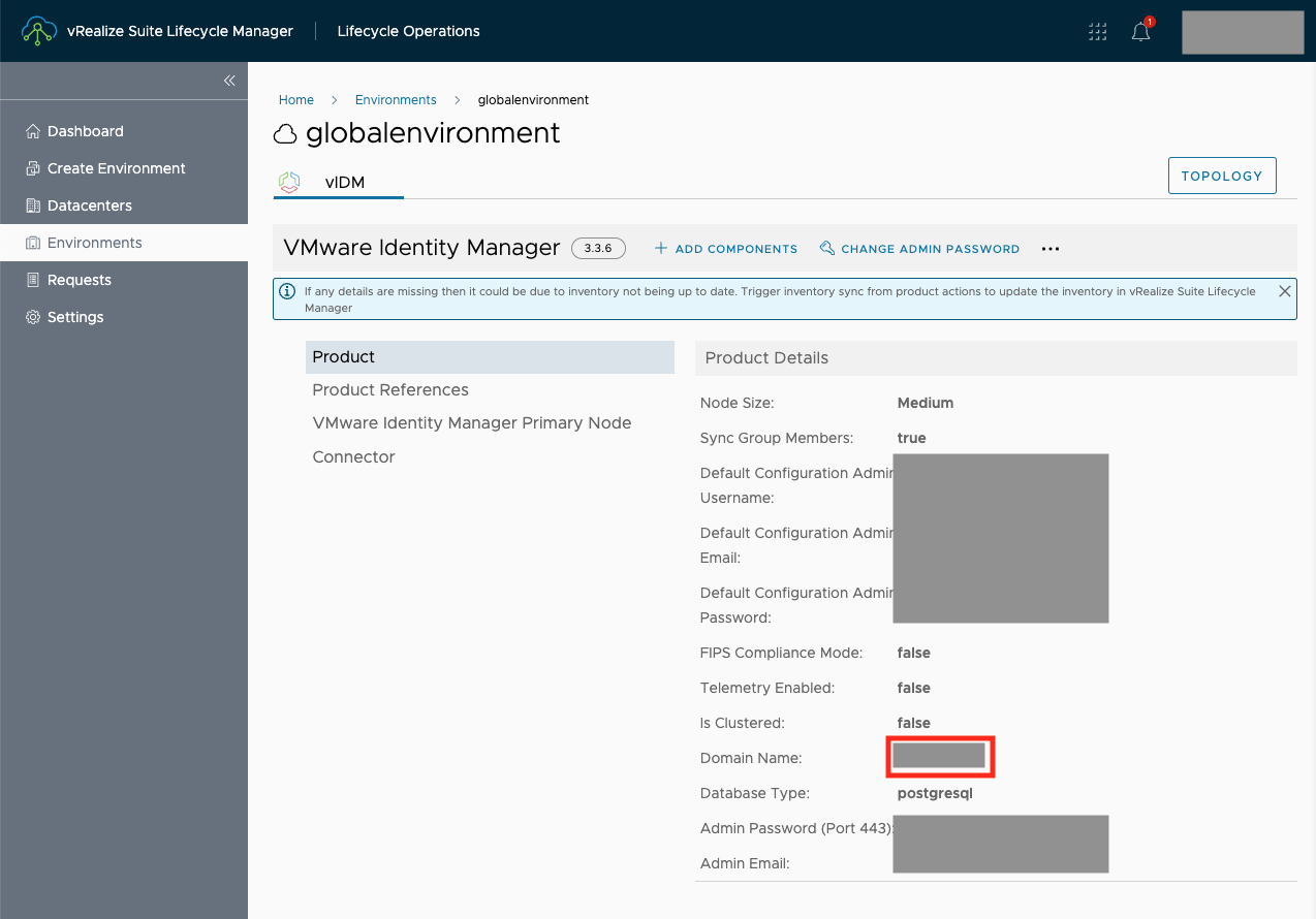

     I noticed the domain name in LCM is different from what I've configured in VRA. Does it matter? Is it the reason that VRA has trouble joining the domain? Just so you know the installation was not done by me.

     VIDM should not have any issue or link for this , Neither Active directory integration  both are separate things
