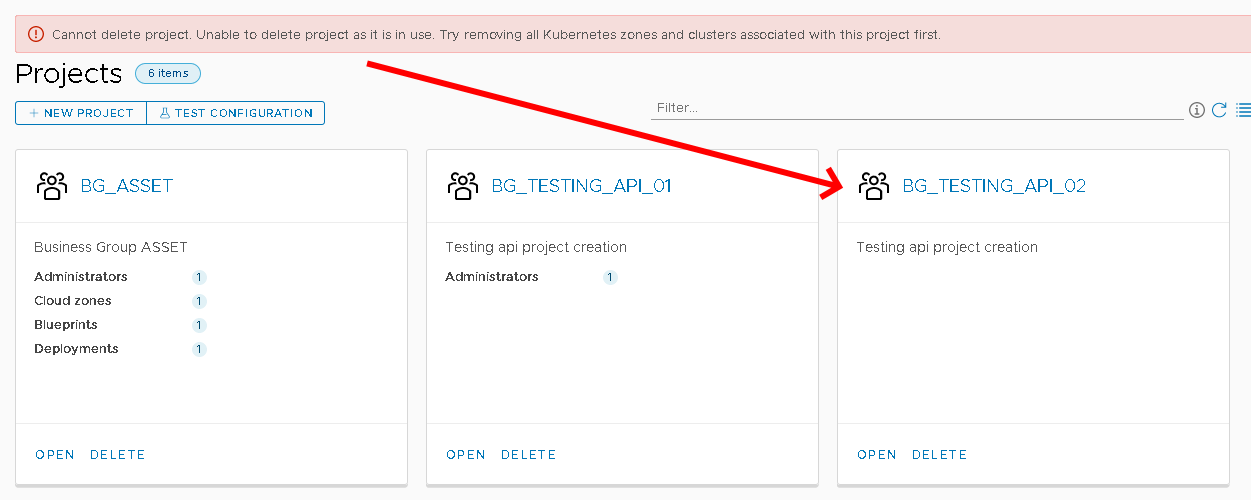

    Hello,
    On vRA 8.1 patch 2 we can't delete an empty project :
    Anyone have this error ?
    Thx for your feedback

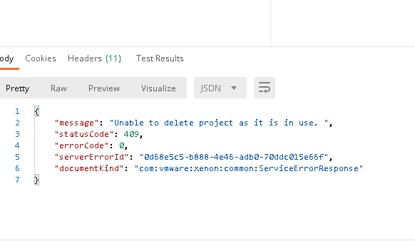

    Thx siglert​,
    Already try... It's the same error :

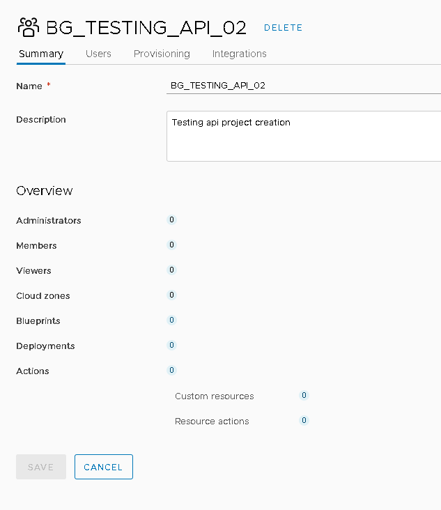

  • 4.  RE: [vRA 8.1] - Cannot delete project
    Posted Aug 19, 2020 12:45 PM
    Could be possible that you actually still have somethings associated to the Project?
    Have you also checked in Service Broker?

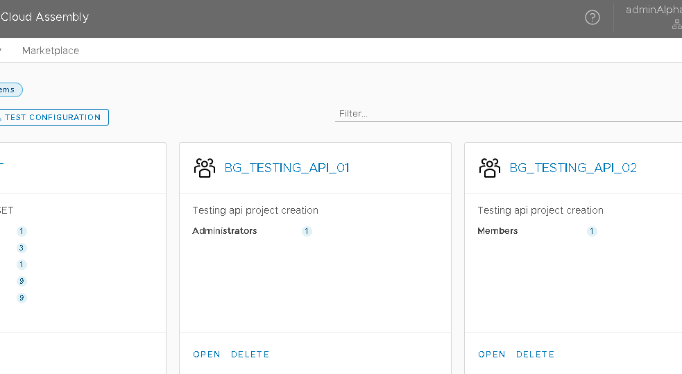

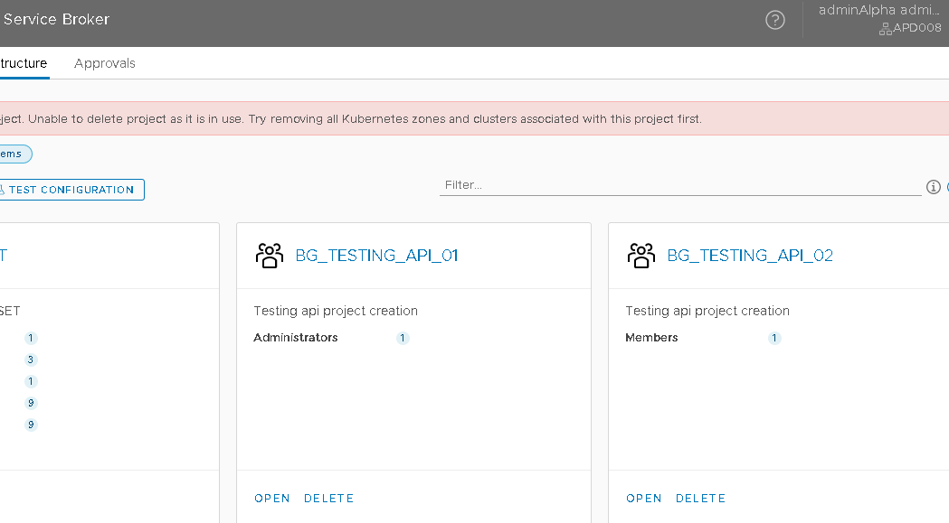

  • 5.  RE: [vRA 8.1] - Cannot delete project
    Posted Aug 20, 2020 06:31 AM
    Nothing on cloud broker :
    Nothing on Cloud assembly :
