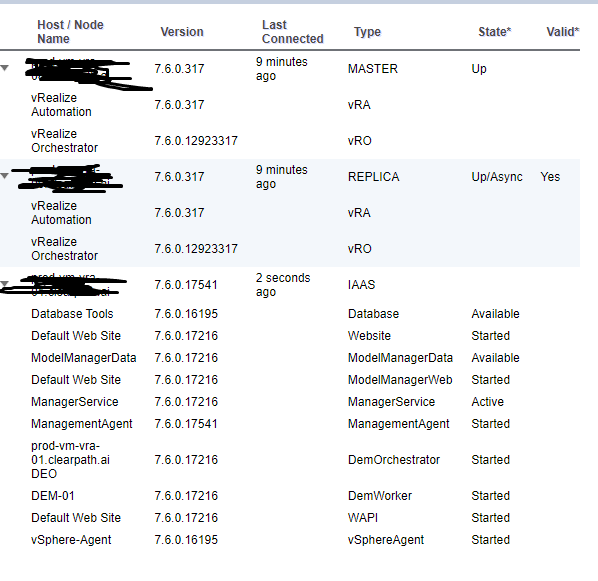

    Go to the VAMI console (Appliance #1 on port 5480) and tell me if the "Cluster" Tab shows everything normal.
  • 5.  RE: vra 7.6 deployments stuck at provisioning
    Posted Jun 21, 2023 08:12 PM
    Everything is showing as healthy from I can tell.

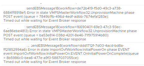

    Posted Jun 21, 2023 10:43 PM
    Hi,
    Looked at logs it seems deployments are timing out waiting for the Event Broker.   I read on another post that disabling the extensibility service is a workaround for this.
  • 10.  RE: vra 7.6 deployments stuck at provisioning
    Broadcom Employee
    Posted Jun 23, 2023 08:43 PM
    This is an unprovision machine event that could be timing out due to another health issue in the environment.
    This information is useful, but can we check the Infrastructure > Audit Log for behavior in the lifecycle states? This can be useful to determine which component is failing based upon which component is responsible for which workitem during said lifecycle.
    We are wanting to filter on the machine from Requested onward.
    V/R,
    Logan
