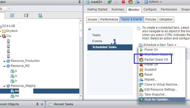

    we try to create a vCenter scheduled task (capture below) on a Virtual Machine from vRO :
    So that, we will use this object :

    now to create "VcScheduledTaskSpec" we need this :
    so, in vRO :

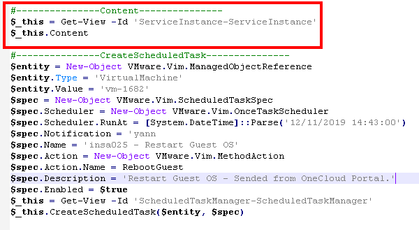

    Ok I understood the general idea.... When we run the "Developer Center" on vSphere 6.5 wee see this line :
    and we didn't understand the function .... Now we understood it's the same of this :
    //Create Service Instance object for vCenter so we can find the scheduled task manager
    sdkConnection = vcVirtualMachine.sdkConnection;
    serviceInstanceReference = new VcManagedObjectReference();
    serviceInstanceReference.type = "ServiceInstance";
    serviceInstanceReference.value = "ServiceInstance";
    serviceInstance = VcPlugin.convertToVimManagedObject(sdkConnection, serviceInstanceReference);
    // Get the serviceContent value from the serviceInstance VcServiceInstance object
    serviceContent = serviceInstance.content;
