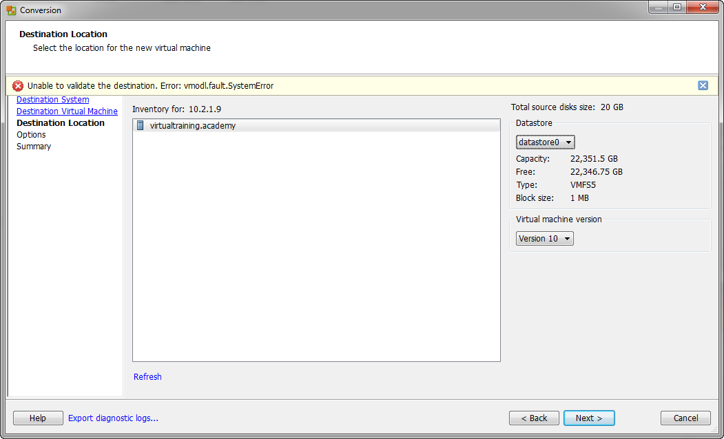

    Today is my second test day with VmWare vSphere (Free Version)
    Our idea is to use vSphere for our training room, means 8 virtual system (Windows 8.1) and our NVR Video management on each machine.
    I use VmWare Workstation on my local desktop. Now i try to upload some of my images to our vSphere Server:
    First try with "VMware vCenter Converter Standalone" but after i login to my server and choose the datastore the software shows me the error message below.
    Second way i try was to upload direct from my VMware Workstation - but after i login to the server the message ist "waiting for host" - and i wait a long time bus nothing happens :smileysad:
    I try the way with the Converter also from the same network where the server is located to be sure that now firewall rule is my issue - but the same error message was shown.
    You find the log file attached to this content.
    Hope somebody have a idea for me ...
    Wish you a nice weekend !
    Jens

    Do you have another, smaller datastore (e.g. less than 2TB) which you can use as the conversion target? And can you confirm that the target ESXi host is running on v5.5 (for HW version 10 support).

    Hi André,
    i have two datastores:
    Datastore1 = SSD Boot Disk about 120 GB
    Datastore0 = ARECA Raid 6 about 22 TB
    I try also to upload the image to datastore 1 but the same error message.
    And it is Hypervisor 5.5 what i use. (I try different HW version - same message)
    Can it be a certification issue ?
    I don't understand why you move the discussion, because i think it is no converter issue - same problem if i try the upload from my VMvare workstation!
    Different sources i also try.
    And confusion is, i install the same hypervision machine to my VMware workstation - and image upload works! (I don´t upload becouse to less disk space but no error message)

    Posted Oct 27, 2014 08:59 AM
    Hello
    Converter connect on port 443 for inventory and management, and on port 902 for data transfer.
    Though I don't think this is your problem. The log reads:
    2014-10-24T12:11:46.841+02:00 [06548 error 'vmomi.soapStub[3]'] Error deserializating SOAP response body:
    --> Error returned by expat parser: not well-formed (invalid token)
    --> while parsing serialized value of type string
    --> at line 7, column 26333
    --> while parsing property "displayName" of static type string
    --> while parsing serialized DataObject of type vim.host.ScsiDisk
    --> at line 7, column 25673
    --> while parsing property "scsiLun" of static type ArrayOfScsiLun
    --> while parsing serialized DataObject of type vim.host.StorageDeviceInfo
    --> at line 7, column 671
    --> while parsing property "storageDevice" of static type HostStorageDeviceInfo
    --> while parsing serialized DataObject of type vim.host.ConfigInfo
    --> error parsing Any with xsiType HostConfigInfo
    --> at line 7, column 33
    --> while parsing return value of type vim.host.ConfigInfo, version vim.version.version9
    --> at line 7, column 0
    --> while parsing SOAP body
    --> at line 6, column 0
    --> while parsing SOAP envelope
    --> at line 2, column 0
    --> while parsing HTTP response for method GetConfig
    --> on object of type vim.HostSystem
    --> at line 1, column 0
    Seems there is something related to the ESX host's storage.
    I'd suggest you get back to the platform forum (don't know which it is) and post more info about the ESX's storage.
