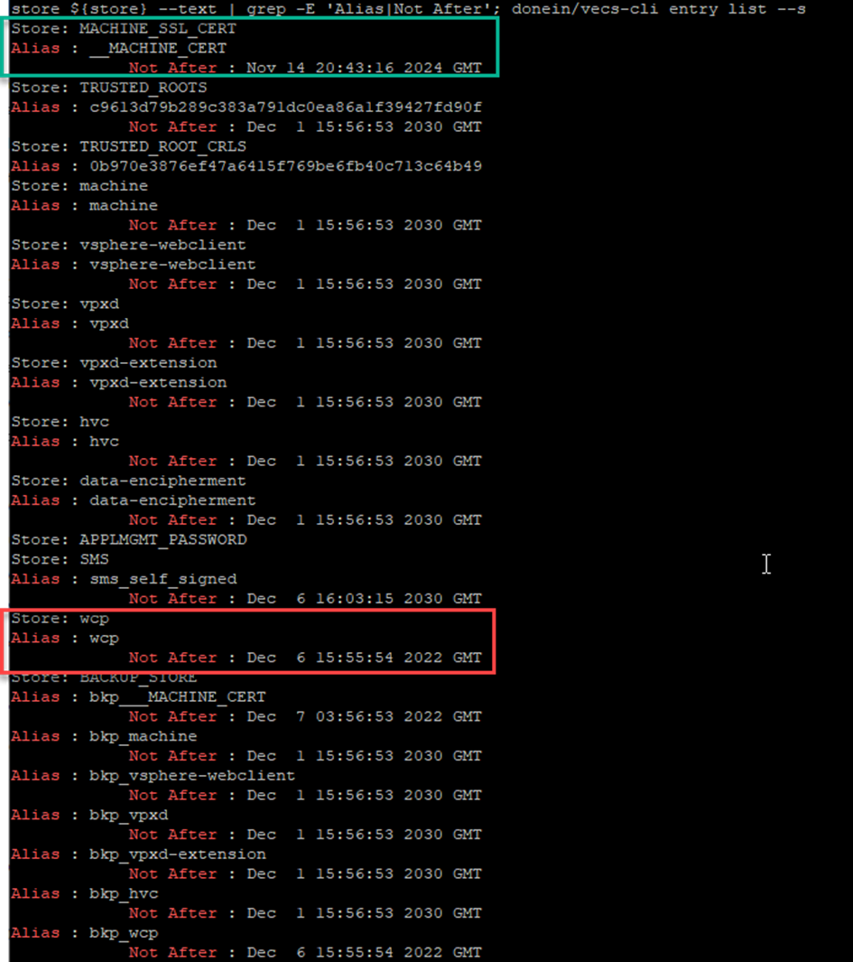

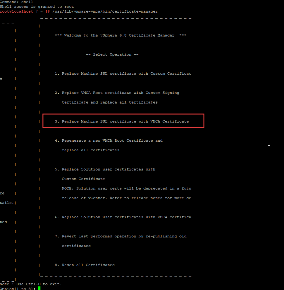

    I want to ask if anyone has encountered a problem with VMware Vsphere, I have several Vsphere 7 machines as an appliance, when renewing the certificate via
    /usr/lib/vmware-vmca/bin/certificate-manager
    3. Replace Machine SSL certificate with VMCA Certificate
    The certificate was exchanged correctly
    is the only one that does not renew the wcp service certificate
    Could someone advise how to extend the wcp certificate
    Thanks for advice
    Jan

    I tried that just now and anyway, even if everything goes correctly, the certificate is not extended according to the statement from
    root@localhost [ ~ ]# /usr/lib/vmware-vmafd/bin/vecs-cli entry getcert --store vpxd-extension --alias vpxd-extension --output /certificate/vpxd-extension.crt
    root@localhost [ ~ ]# /usr/lib/vmware-vmafd/bin/vecs-cli entry getkey --store vpxd-extension --alias vpxd-extension --output /certificate/vpxd-extension.key
    root@localhost [ ~ ]# python /usr/lib/vmware-vpx/scripts/updateExtensionCertInVC.py -e com.vmware.vim.eam -c /certificate/vpxd-extension.crt -k /certificate/vpxd-extension.key -s localhost -u Administrator@vsphere.local

    root@localhost [ ~ ]# for store in $(/usr/lib/vmware-vmafd/bin/vecs-cli store list); do echo "Store: ${store}"; /usr/lib/vmware-vmafd/bin/vecs-cli entry list --store ${store} --text | grep -E 'Alias|Not After'; done
    Store: MACHINE_SSL_CERT
    Alias : __MACHINE_CERT
    Not After : Nov 14 06:54:07 2024 GMT
    Store: TRUSTED_ROOTS
    Alias : acb1e65697cee71c29c05a0925292204990c63c0
    Not After : May 23 08:40:12 2032 GMT
    Alias : b77b71b904ccb81332a2d573698d31456f893abc
    Not After : Nov 8 19:30:05 2032 GMT
    Store: TRUSTED_ROOT_CRLS
    Alias : 664479f1314f9cac731f22485299022521a97d06
    Alias : 5eb5e2cad8bc06f917bef01c43678164fe3f7034
    Store: machine
    Alias : machine
    Store: vsphere-webclient
    Alias : vsphere-webclient
    Store: vpxd
    Alias : vpxd
    Store: vpxd-extension
    Alias : vpxd-extension
    Store: hvc
    Alias : hvc
    Store: data-encipherment
    Alias : data-encipherment
    Store: APPLMGMT_PASSWORD
    Store: SMS
    Alias : sms_self_signed
    Not After : May 29 08:45:00 2032 GMT
    Store: wcp
    Alias : wcp
    Not After : May 28 08:37:11 2024 GMT
    Store: BACKUP_STORE
    Alias : bkp___MACHINE_CERT
    Not After : May 28 20:40:12 2024 GMT
    Alias : bkp_machine
    Alias : bkp_vsphere-webclient
    Alias : bkp_vpxd
    Alias : bkp_vpxd-extension
    Alias : bkp_hvc
    Alias : bkp_wcp

    Before 7.0U2, wcp certificate as well as Machine SSL Certificate expire in 2 years , so it was correctly updated to 2024 from 2022.
