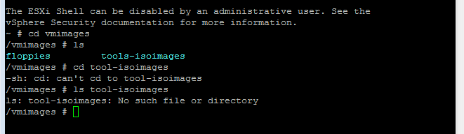

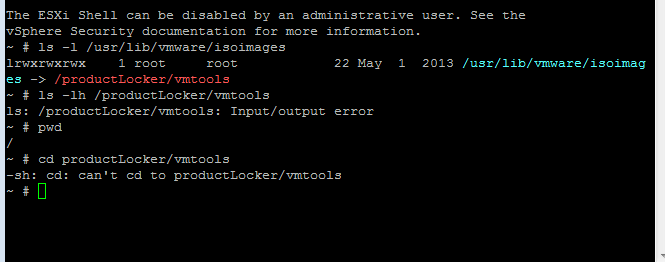

    I have some guest vms with a yellow exclamation point on the vmware tools icon indicating they can be updated. When I try and update vmware tools manually, I get the error: "The required VMware Tools ISO image does not exist or is inaccessible. See the error stack for details on the cause of this problem." Below in the Error Stack window, I see the messages, "Call "VirtualMachine.MountToolsInstaller" or object <servername> on ESXi "192.168.3.39" failed. Unable to install VMware Tools. An error occurred while trying to access image file "/usr/lib/vmware/isoimages/windows.iso" needed to install VMware Tools: 0 (Input/output error). If your product shipped with the VMware Tools package, reinstall VMware ESX, then try again to install the VMware Tools package in the virtual machine."
    I found posts that indicated I should check symlinks to the vmtools directory and I think those are present. I also tried to manually browse to the image folder but it appears there is a problem of some sort with the file system. See images below:
    ESXi is installed on a USB stick. Is the iso images directory corrupted? Can anyone help me on how I can fix this? Should I just replace the USB stick or is there another way?

    Seeing the Input / Output error on screen usually indicates a faulty disk (or in this case USB device). I wouldn't waste much time and replace the USB stick.
