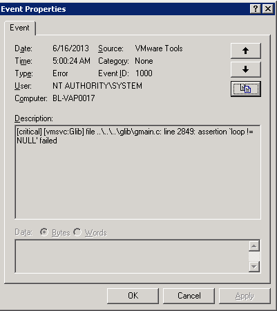

    We use Windows server 2003 R2 and ESXi 5.1. We use Vmware tools 9.0.5 build 1065307.
    In our event logs we sometimes see this message:
    Event Type:Error
    Event Source:VMware Tools
    Event Category:None
    Event ID:1000
    Date:6/16/2013
    Time:5:00:24 AM
    User:NT AUTHORITY\SYSTEM
    Computer:BL-VAP0017
    Description:
    [critical] [vmsvc:Glib] file ..\..\..\glib\gmain.c: line 2849: assertion `loop != NULL' failed
    We dont have any problems on the server, been googling for this problem, no results. So if anyone has an idea... let us know!

  • 9.  RE: Vmware tools generates Windows events: Event ID: 1000
    Posted Jun 16, 2014 07:43 PM
    Try this & let me know if it is helpful
    Go to C:\Documents and Users\All Users\Application Data\VMware\VMware Tools
    Create a file tools.conf In the file put this (I only used [unity] as the other portion disables logging which I didn't want to do)
    [unity]
    pbrpc.enable = false
    [logging]
    vmusr.level = error
    vmsvc.level = error
    Go to C:\Program Files\VMware\VMware Tools\plugins\vmusr
    and rename unity.dll to unity.dll.orig or an extension of your choosing.
    Reboot
    Hope this is helpful for someone
