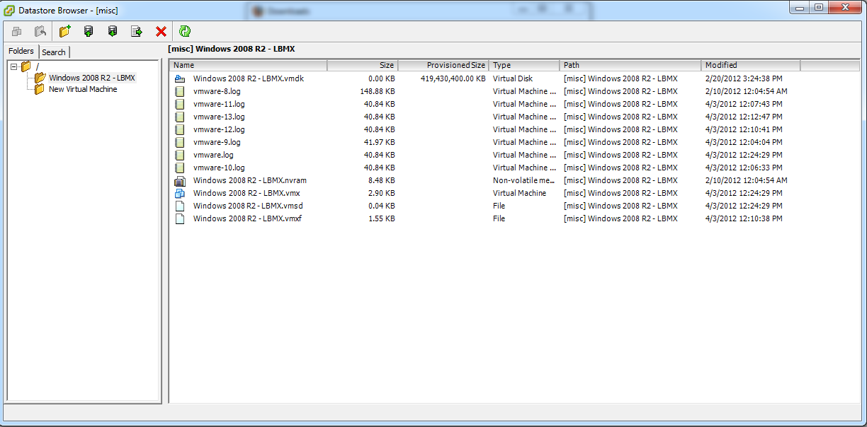

  • 8.  RE: VMware ESX cannot find the virtual disk
    Posted Apr 03, 2012 08:41 PM
    ok I was able to find the directory and indeed the file is there.  see attached screen shot.  What is concerning to me is that windows is showing the vmdk file as only being 1 KB.  Could that be the problem?  I don't know how all of the data would just disapper.
  • 9.  RE: VMware ESX cannot find the virtual disk
    Posted Apr 03, 2012 09:41 PM
    you should also have
    "/vmfs/volumes/a5382f67-077d12c4/Windows 2008 R2 - LBMX/Windows 2008 R2 - LBMX-flat.vmdk"
    the name-flat.vmdk is the one that actually stores the data - the 1kb small vmdk is only a description
    flat.vmdks are only visible with tools like winscp, ssh ....
    Datastorebrowser does not display  vmdk-files correctly
