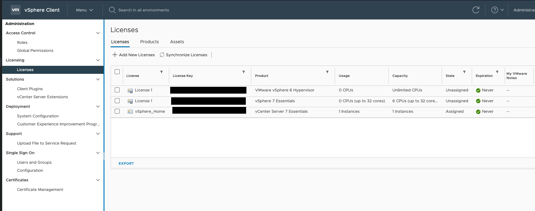

    Please capture an image of the vCenter server's license tab (covering the keys)and put it in the post
  • 13.  RE: VMware Essentials Install / Licensing
    Posted Jan 12, 2021 12:50 AM
    Here's my licensing screenshot
  • 14.  RE: VMware Essentials Install / Licensing
    Posted Jan 12, 2021 02:15 AM
    Hello.
    please remove the first license (vmware vShpere hypervisor 6) from the list on the vcenter server
    only licenses 7 must be present.
    Now try again to include the ESXi host in the vcenter server,
    please capture and paste the screen if it shows any error.
    Please indicate the vcenter server build you have and the ESXi Host build to validate compatibility.

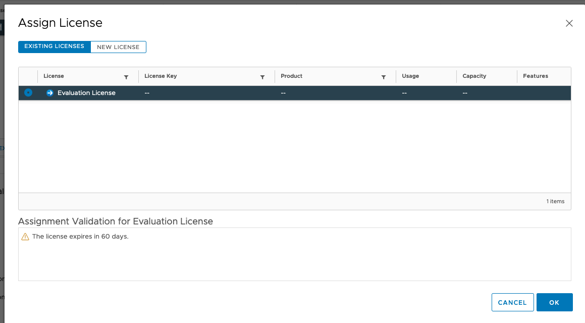

  • 15.  RE: VMware Essentials Install / Licensing
    Posted Jan 12, 2021 02:01 PM
    Hi Enrique - thanks for the help!
    It seems when I attempted to import my vmware01 host, that license was imported to vcenter and looked like the correct choice in the drop-down list when adding a new host (given the other option was "evaluation license") and it came up highlighted as the default.  Given my lack of familiarity, I simply let that go.  After removing the license from both the vCenter server and the ESXi host, the only license options in the install was the Evaluation License, which I accepted, and now the host imported. But it is still running on the evaluation license.  When I attempt to assign a license, nothing is available.  My impression when purchasing the Essentials Kit was that ESXi6.7 hosts were supported.  Is that not accurate, do I need to upgrade?

  • 16.  RE: VMware Essentials Install / Licensing
    Best Answer
    Posted Jan 12, 2021 06:06 PM
    Hello.
    the licenses you have in the vCenter server are for version 7.0 and the ESXi hosts are in version 6.7 but they are not licensed.
    The vCenter Server cannot manage them without a valid (not free) license.
    In your case you have to upgrade the ESXi hosts to version 7.0 to be able to assign them the licenses (version 7.0) that are in the vCenter server.
    It is recommended to enter the license in the ESXi host where the Vcenter Server is located as a VM
    Another option is to log in to My VMware where you register your VMware vSphere Essentials kit and downgrade licenses to version 6. In this option you would have to reinstall the vcenter server to have all the licenses in order.
    How to Upgrade or Downgrade License Keys in My VMware with troubleshooting steps (81665)
    https://kb.vmware.com/s/article/81665
