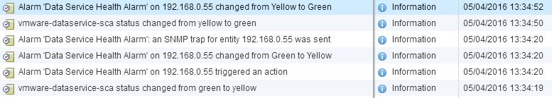

    After having issue with VDP, I start seeing this message every 5 minutes, the alarm is configured in "Data Service Health Alarm", I have changed the triggering action to trap instead of sending email for now, till I resolve the VDP issue with VMWare.

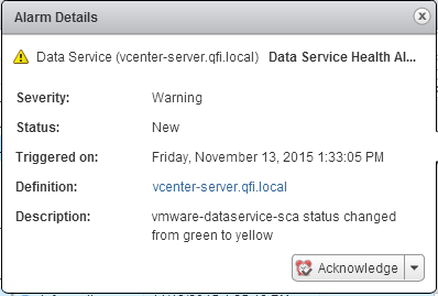

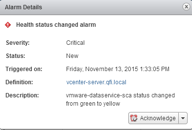

    Just wanted to post stating we are seeing the exact same thing. we get the two alarms.
    vmware-dadaservice-sca status changed from green to yellow which is concidered a critical alarm
    we also get the warning vsphere-client status changed from green to yellow
    if we reset to green within 1-2 min it will come back. I have noticed though that if i open only the web client and clear both of them and then open vsphere they pop up as soon as vsphere is done loading. has been since I updated to 6.0U1

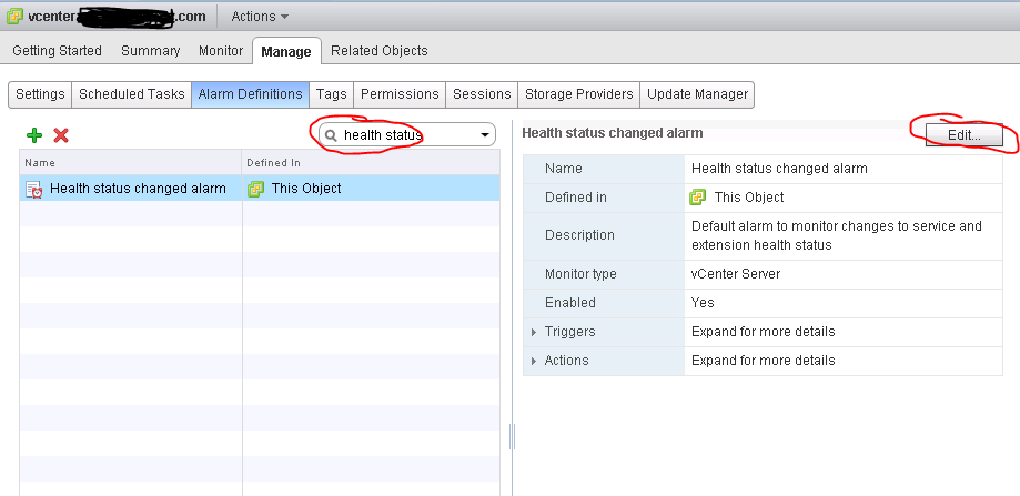

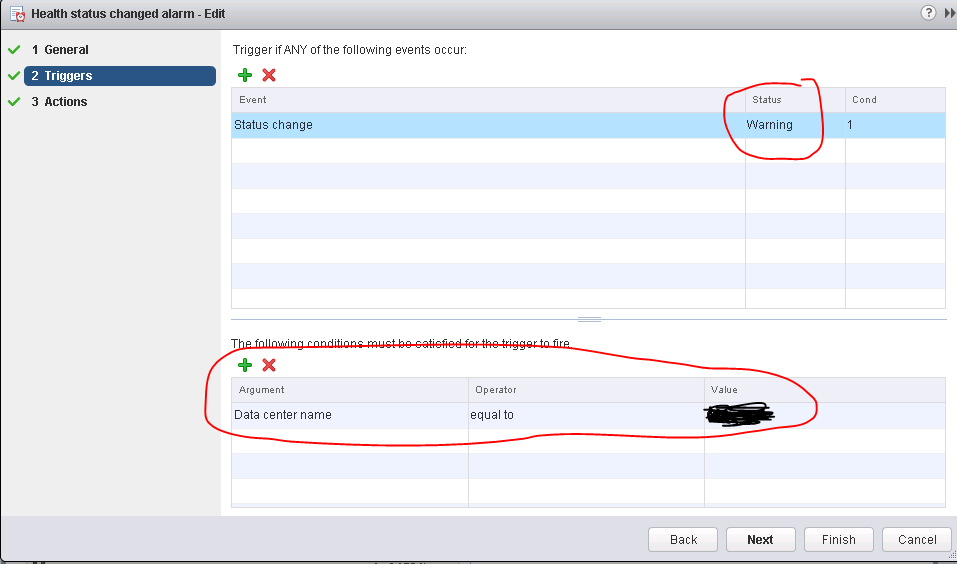

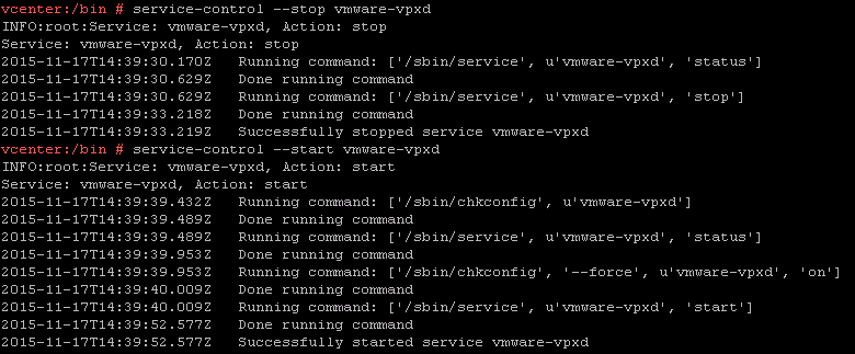

    Just got the issue fixed by support. EDIT:: This is a "good" fix.  Issue has never come back.  The instructions pertains to VCSA (Not windows server.)
    As folks have noted, it is a known issue in vCenter 6 Update 1 (VCSA,) but I recall having the issue some when I was running vCenter 6.  The fix appears to legitimately take care of the problem, not just turn off stateless alarms in whole.  I mentioned to my support rep that a bunch of folks would appreciate a KB article on this, but until one comes out, here are the steps.  Sorry they are a bit generic, but hoping you can follow.
    1) Log into vCenter. Go to Alarm Settings --> Health status changed alarm --> Edit Settings -->
    2) Under Triggers --> Change Status from Unset to Warning.  In advanced options on the same page --> Add argument data center name --> Operator as equal to --> Value is Data Center name.
    3) Restart the vCenter Server Services by logging in via Putty, running "service-control --stop vmware-vpxd" then "service-control --start vmware-vpxd"
    Hope this helps some folks!

    I've also created a VMware SR for this and their response (which worked for me) is:
    1) Log into vCenter server using thick Client/ vsphere client. Navigate to Alarm Settings *--> Health status changed alarm --> Edit Settings --> Triggers --> Change Status from unset to Warning.
    2) In advanced options on the same page --> Select argument as data center name --> Operator as equal to --> Value is Data Center name.
    3) Click on Actions Tab --> Select warning to alert and Warning to OK as once.
    4) Restart the vCenter Server Services.

    Posted Apr 05, 2016 12:42 PM
    Ah ok! :smileylaugh:
    The solutions that you have indicated keep at bay the alarms, but in the event console I still see information like below. I'm not sure if are ok.....

    I've tested this solution, work in parts, but not sorted. there is a workaround that is:
    1) Logged in to VC using thick Client. Go to Alarm Settings --> Health status changed alarm --> Edit Settings --> Triggers --> Changed Status from unset to Warning.
