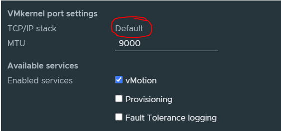

      |   view attached
    I select vMotion in the VMkernel settings which I believe creates a separate TCP/IP stack, see attached screenshot. Is that what you are asking about?

    Selecting vMotion at the point in your screenshot only marks the prot group as a vMotion port grou, but does not create a separate stack. Please see Place vMotion Traffic on the vMotion TCP/IP Stack of an ESXi Host for how to configure the vMotion stack to allow routing.

    That screenshot is of the VMkernel not the Port Group. Thank you for providing that link, that is exactly how I created the VMkernels for vMotion on my hosts so I guess they do have a separate TCP/IP stack.

    Your screenshot shows that you may have missed to select the vMotion TCP/IP Stack from the drop down menu as mentioned in the documentation (step 7). You've created the vMotion VMkernel port group in the "Default" stack
