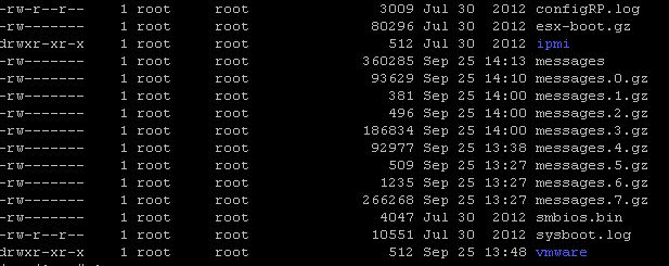

  • 7.  RE: VMkernel logs missing
    Posted Sep 25, 2013 02:21 PM
    Thanks, found the "messages" log by ls-l
    But here I can see messages.x.gz files also (where x is from 0 to 7)
    Actually we received alert "Host is not responding" on 24th September 2013 at 11:00 PM EST. But above messages files shows just 25th september. I have attached the screenshot.
    So how to check for 24th September
    Also how to read this .gz files in SSH.
  • 8.  RE: VMkernel logs missing
    Best Answer
    Posted Sep 25, 2013 03:00 PM
    Usually in log rotation, the file containing a date will have all the logs before that time. So look for the file closer to 24th september 2013. Btw, you can use
    zcat <filename.gz> | less or gunzip <Filename.gz> and do a cat on that file.
