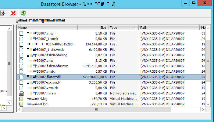

    We are using vSphere 6.0.0 (Build 2741530).
    When browsing a datastore and having a look at VM files there are no "virtual disks" (type) displayed.
    There are just -ctk.vmdk and -flat.vmdk:
    This worked fine with vCenter 5.5.x.
    Is this a bug or a configuration issue?

    vsphere 6 seems to show the truth behind the vmdk files.
    when you browse the datastores with DCUI you see also those files:
    flat.vmdk. (Diskcontent)
    ctk.vmdk (CBT File)
    .vmdk (Disk description)
    in vsphere the datastore browser showed only the .vmdk file to not confuse the enduser. but the truth is that there are those thre files for each virtual disk...

    Thanks for the reply. I know what the file structure is on ESXi CLI.
    The point is we would prefer the friendly-version for debugging and working with snapshots...
    Beside that we found out that the display of type "virtual disk" works with 2 ESXi servers but doesn't with all others.

    I did some further tests. This problem is not related to the ESXi server but to the virtual machines.
    I migrated a VM from one host to another and to another datastore; the type "virtual disk" was always shown.
    It is independent off virtual hardware too.
    CU

    when I log on directly to an ESXi host by vSphere Client everything is okay. (virtual disk is displayed with every VM).
    The problem seems to be with vCenter; with our old vCenter (version 5.5) this didn't happen.
