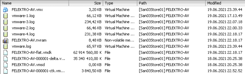

    The missing VMDK file is called "FELEKTRO-AV-000001.vmdk", but when browsing the datastore, I only see the following files:
    So I have an FELEKTRO-AV-flat.vmdk file, and I have an FELEKTRO-AV-000001-delta.vmdk. Is there any chance that these are the base VMDK file and a snapshot?

    If you re-create a VMDK descriptor file you have to take care of the reference (-flat.vmdk) and of course the parent when you have a VM which runs on Snapshot(not a good idea).
    So create a new FELEKTRO-AV-000001.vmdk with reference to FELEKTRO-AV-000001-delta.vmdk and parent FELEKTRO-AV.vmdk.
    But you may have f*cked it up already because your base VMDK get new changes (it have newer date right now) because you create the descriptor wrong and powerd it up. Since your Snapshot is extremly large and holds more than 50% (no wonder if its there for 4 years!) there is a small change that you can override the already changed blocks. You should make a copy of all files first before start messing around.
    Its also possible to merge the snap and base back into a single vmdk and than run some windows filechk on.

    I always fix stuff like these in a simple way because iam not so savvy when it comes to the descriptor file.
    1. Create a new Dummy VM with the same specs (SCSI Controller, Disksize, Disktype)
    2. Create a snap on the VM
    Now you can use the dummy.vmdk and dummy-000001.vmdk as a template and just copy and rename it into your VM which is in trouble. Make the changes to match your flat/delta and the reference of course.
    grep vmdk *.vmx
    show which Disks are configured within the VM.
    There is a vmkfstools parameter for checking the snapshot chain.
