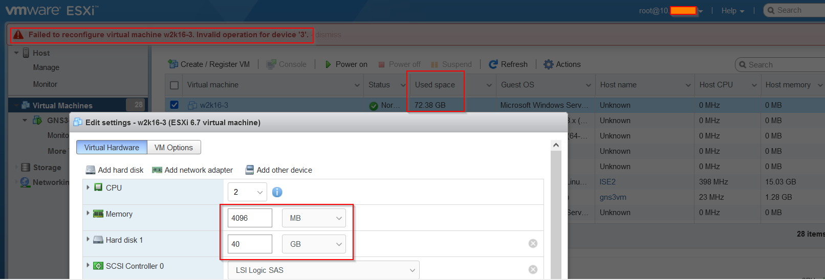

    Hi One of vm windows 2016 is installed at esxi6.7. Recent the windows server shut down by itself after runing about 10 min. Can you please see if the there is some configuration issue? I post the screenshot as below. Thank you

    Hi
    According to the screenshot, your VM's configurtion is OK and If you think that the cause of the problem is not related to OS itself, you can check the vmware.log file for more information.
    You can also check your OS power plans to be sure that the cause of the problem is not some misconfiguration of that section.
