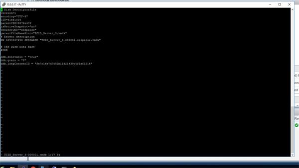

    thanks for your support, unfortunately, the size of a small VMDK is over 18GB, alternative I attached the Descriptor File for each VMDK, I think I should edit the CID for the snapshot disks but I don't know how and what should change.

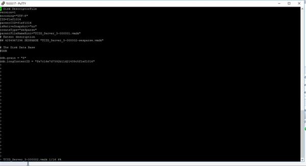

    Did you already modify these files? vmname-000002.vmdk has the same value for CID and parentCID?

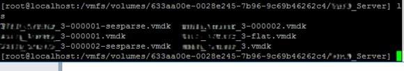

    Please run ls -lisa *.vmdk an post the result (as plain text please).

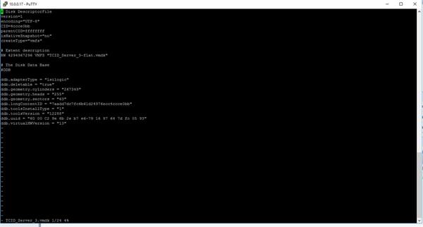

    Disregarding the issue with vmname-000002.vmdk, what you need to do, is to set the parentCID in vmname-00001.vmdk to the value of the CID from the base virtual disk file, i.e. parentCID=4ccce0eb
    Please remember to reload the VM in case you are editing files manually.
