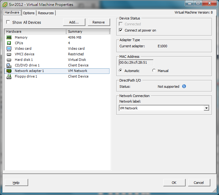

    I have a vSphere host A (192.168.1.141) and the host gateway is 191.168.1.1. I have set up VM B (192.168.1.199), VM B can connect to the gateway. Then I set up VM C (192.168.1.39), this time, I cannot connect, even ping the gateway (192.168.1.1) but I have already turn off the windows firewall. Anything I have done wrong?
  • 2.  RE: VM Unable to Connect to vSphere Gateway
    Posted Aug 09, 2018 01:36 AM
    Is VM-C connected to the right network? Can you share some pics of your host network configuration, VM network connection from VM --> Edit Settings tab and the VM network configuration from within the guest OS (ipconfig or ifconfig)?

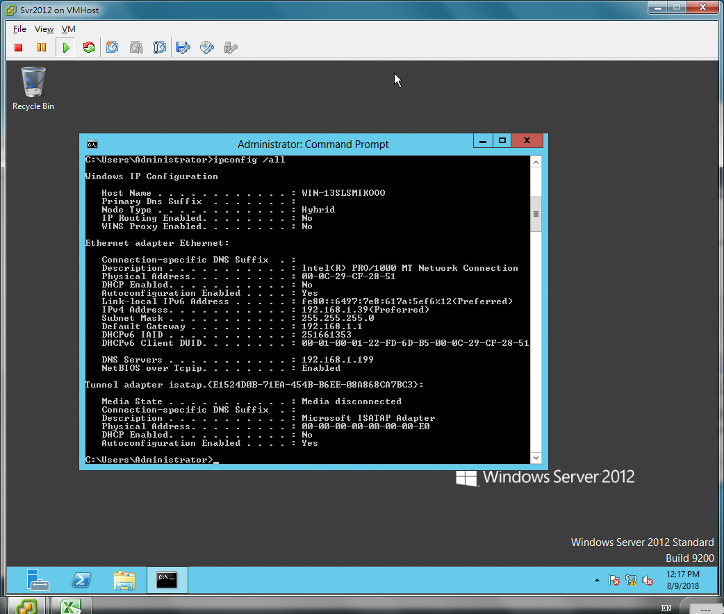

  • 3.  RE: VM Unable to Connect to vSphere Gateway
    Posted Aug 09, 2018 03:44 AM
    Thanks for your help. In fact, VM C (192.168.1.39) can ping the vSphere host A (192.168.1.141) and VM B (192.168.1.199). Attached please find the NIC config and IP config.
  • 4.  RE: VM Unable to Connect to vSphere Gateway
    Broadcom Employee
    Posted Aug 09, 2018 07:55 AM
    @Mats_Hardy thanks for sharing the screenshots, As we understand the VM is connected to the VM Network, with the defined Static IP allocations on the Guest,

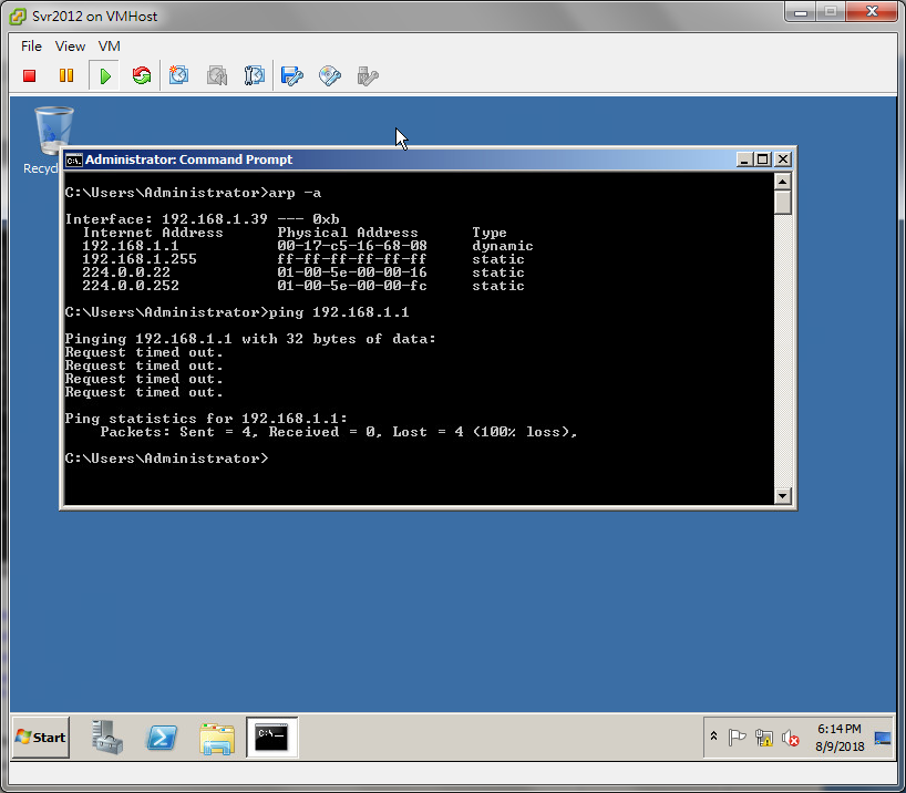

  • 5.  RE: VM Unable to Connect to vSphere Gateway
    Posted Aug 09, 2018 09:37 AM
    Thanks for your help. In fact, the VM host does not have any external gateway. The gateway is installed by default on VM host. Besides, I have checked the ARP table on both VM B and VM C. Both are the same. The MAC address of gateway (192.168.1.1) should be correct on VM C but cannot be pinged. Attached please find the screen dump.
  • 6.  RE: VM Unable to Connect to vSphere Gateway
    Posted Aug 09, 2018 10:09 AM
    Just a thought.
    What type/model of physical switch do you use? Some switches have port security enabled on their ports by default, which limits the number of simultaneous allowed MAC addresses. Depending on the switch model, such a feature may be called differently (e.g. Desktop Mode, ...). Changing the port to e.g. Access Mode solves will do in such cases.

  • 7.  RE: VM Unable to Connect to vSphere Gateway
    Broadcom Employee
    Posted Aug 09, 2018 05:36 PM
    So the ARP references show the Gateway Address. It shd more likely be a ARP cache issue, I am sure, if you vMotion/clear arp cache on the Network Switch it should very well update the MAC table entries, and should start communicating to the Gateway.

  • 8.  RE: VM Unable to Connect to vSphere Gateway
    Best Answer
    Posted Aug 14, 2018 07:10 AM
    Thanks for all your help, I have just asked system admin, he replied that specific MAC addresses are configured for the VMs. After I input the MAC address assigned by him, the VM can connect to the gateway now.
