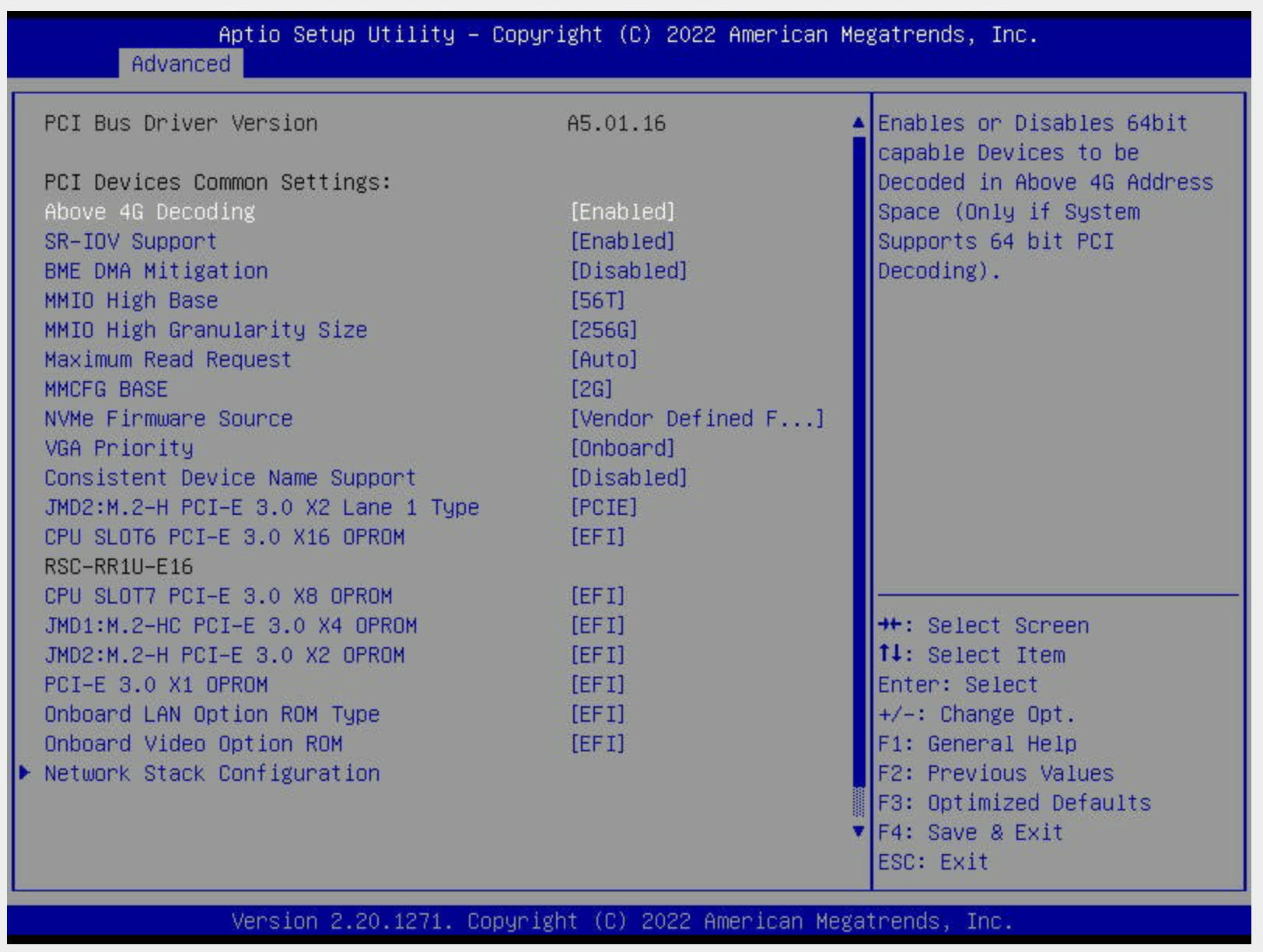

    BIOS is as follows:

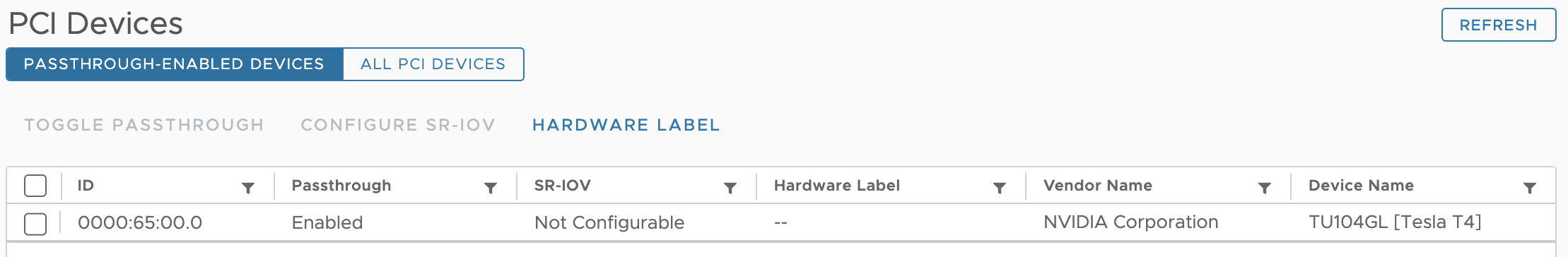

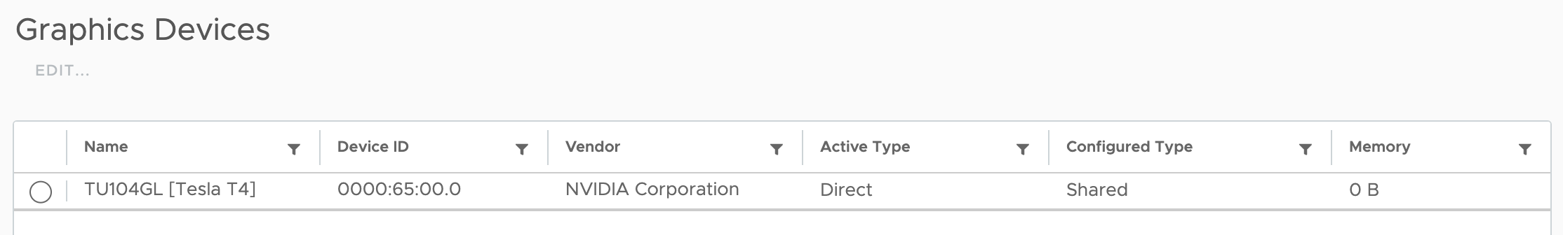

    The GPU shows up in the Vsphere UI as follows:
