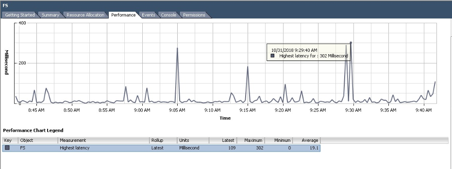

    I am facing latency issue in Particular VM in ESXi 6.0. The VM has Windows server 2012R2 OS. It contains AD user profiles and network share files.
    Am facing issue only office working hours. While checking Performance Chart I found Disk read and write latency going more than 300ms.
    Anyone tell me what is the normal disk latency? and any idea about this.

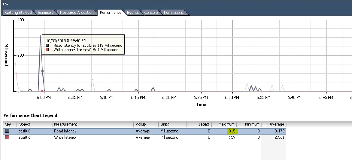

  • 4.  RE: VM disk Read/Write latency is more then 300ms
    Posted Oct 30, 2018 04:06 PM
    Sample Image for your reference.

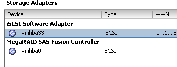

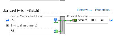

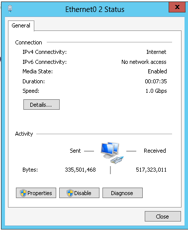

    Can you provide details about the back-end storage and network that is being used?
  • 7.  RE: VM disk Read/Write latency is more then 300ms
    Posted Oct 31, 2018 09:20 AM
    I have created a separate virtual switch for this  VM and directly allocated a physical NIC to that VM. We are using IBM ds3512 ISCSI Storage.
    Physical NIC :-
    VM NIC:-

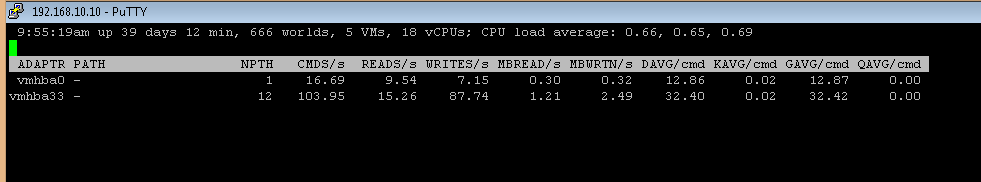

    ESXTOP can help you identify where the problem is occurring.  https://kb.vmware.com/s/article/1008205 I've used this many times to help see where the problem is occurring.  VM, Host, Storage.  I hope this helps.
  • 10.  RE: VM disk Read/Write latency is more then 300ms
    Broadcom Employee
    Posted Nov 01, 2018 09:33 AM
    I would recommend to look at ESXTOP first to identify where the issue is occuring:
    http://www.yellow-bricks.com/esxtop/
  • 11.  RE: VM disk Read/Write latency is more then 300ms
    Posted Nov 01, 2018 09:56 AM
    Hi,depping
    See the output of esxtop.
