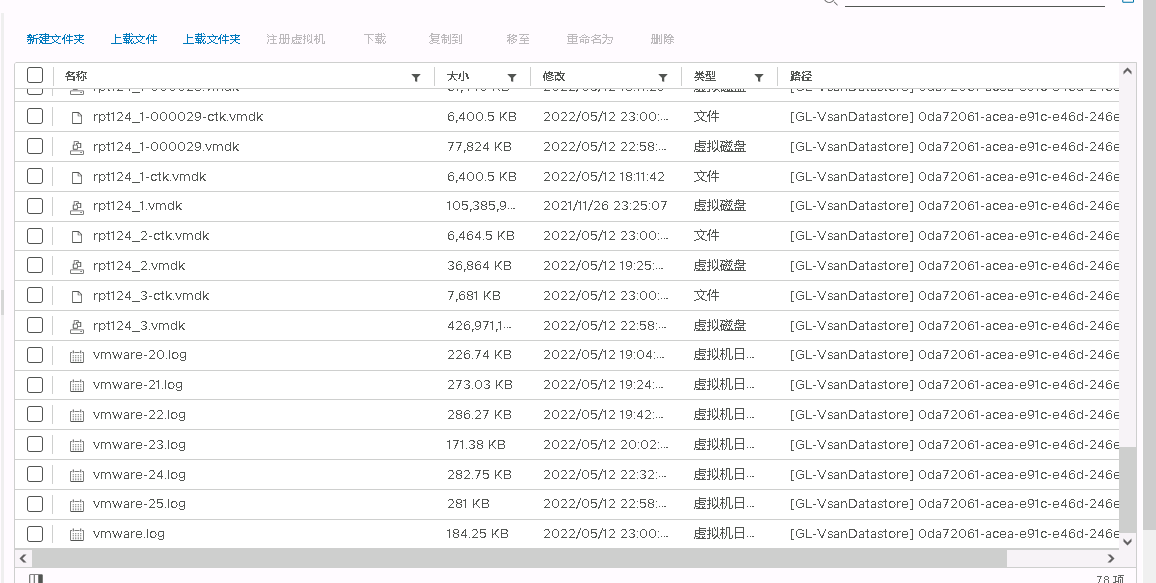

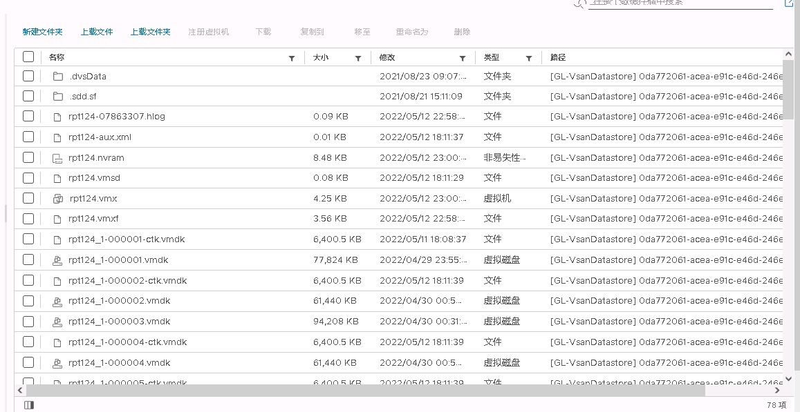

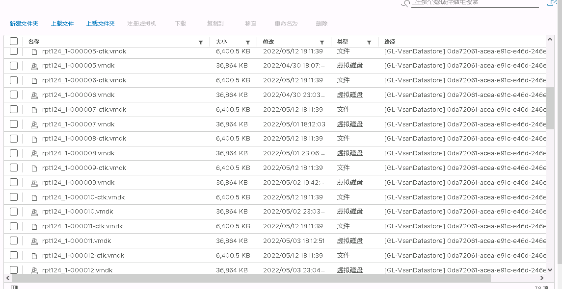

    No snapshots can be found ??? - do you trust Snapshotmanager ?
    That guy has no clue about the number of snapshots that are in use as soon as your vmsd-file is corrupt.
    Your screenshots show that you have about 29 snapshots - please dont attach images in such a  way that the full content is invisible. ...
    -v10 in vmkfstools commands sets the verbosity-level. v10 means : show all details
    I looked at the link you mentioned and I would suggest to delete the bookmark - not useful ...

    Hello Thank for your reply. What I said "No snapshot" means in snapshot manager, there is no snapshot and there is no snapshot.vmdk file in storage.
