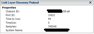

    You only get real CDP/LLDP uplink through distributed vSwitches. This is from an uplink on a dvSwitch that has LLDP enabled:
    \==+Physical Nic :
                |----Name...............................................vmnic1
                |----Network Hint.......................................71 10.20.10.229/255.255.255.255, 78 10.20.8.0/255.255.255.128, 77 169.254.89.75/255.255.255.255 [...]
                |----Link Up............................................true
                |----enabled............................................true
                |----CDP Network........................................false
                |----LLDP Network.......................................true
                \==+LLDP Summary :
                   |----Chassis ID......................................xxxxxxxxxxxxxx
                   |----Port ID.........................................14005
                   |----Time-to-live....................................112
                   |----Timeout.........................................0
                   |----Samples.........................................2
                   |----System Name.....................................xxxxxxxxxxxxx

    This is disappointing.  VMware specifically calls this "CDP".  Yet it does not in fact implement the true cisco discovery protocol either in the network health check or through any of the command line options available to ESXi.  I think this is misleading.  ESXi is not in fact capable of inspecting a CDP advertisement and pulling all the information from it.  Yet it says you have 3 options, "listen, advertise or both".  It makes it look just like a Cisco switch implmentation of CDP.  Yet it really is not.  It can't tell you all the information coming in on the switch advertisement packets.  If you come to the ESXi command line expecting ESXi "CDP" to give you the info that the CDP protocol is designed to, you will come away with an incomplete or wrong impression of how things are configured.
  • 7.  RE: vLAN not showing in ESXi CDP output
    Posted Jul 16, 2013 09:38 AM
    I'm not sure what exact kind of info CDP really provides, like if it contains a list of enabled VLANs in the link, but ESXi distributed vSwitches do in fact handle CDP/LLDP in both directions and can extract some information out of it. This is not implemented in the network health check function but separately from that.
    You can see that in the esxcfg-info of my example above and in the network configuration section on the respective vmnic:
    The vim-cmd networkhints command is just a misunderstood stepchild of the "observed IP ranges" which has been around since ages in that regard.
