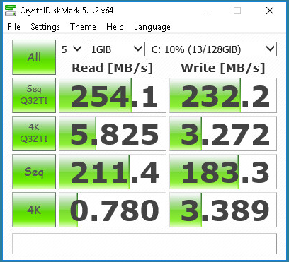

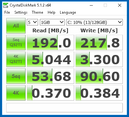

    Just thought I would add my results to this. I was having performance issues with Microserver, although apparently not as severe as some of you were having. I decided to run a basic benchmark before and after changing the drivers. Results were quite dramatic and I could tell as soon as I booted the VM that the performance had changed.
    I ran Crystal Disk Mark (all default settings) and the output is as follows:
    ESXi 5.5.0 U3a
    Before (v100 drivers):
    After (v88 drivers):
    Don't really understand the significance of the numbers that Crystal Disk Produces, but the numbers seem a lot higher!
    Thanks for the help all.

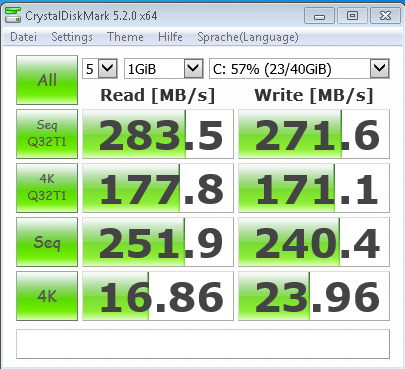

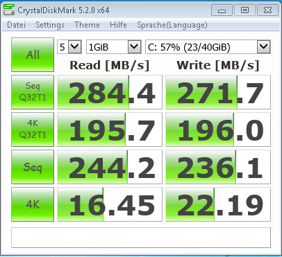

    Just wanted to share my results with you guys.
    I've startet with this setup.
    v88 with ESXi 6.0 Build 4510822
    Then i have updated my ESXi to the latest build and installed the latest hpvsa driver (v102)
    v102 with ESXi 6.0 Build 4600944
    And because of the bad results, i've switched back to the old driver (v88) with the new ESXi Build
    v88 with ESXi 6.0 Build 4600944
    Keep at v88 if you want to have good performance.
