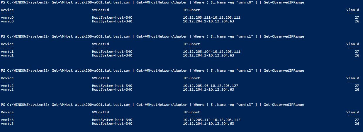

    For testing purpose we defined all necessary VLANs for all pysical ports (pnics) and assign each portgroup one of VLAN - ID. So, from this side, there should be no problem. I will check on esxi side if there are all VLANs visible!
    Thank you!
    Update:
    We've made the described changes on the first two ESXi hosts (and switch ports) on a new VDS as described above.
    The next days we will monitor the VDS health check, if the the teaming/failover warning still occurs. I checked the visible VLANs and they are OK, from my point of view. We can see both VLANs on all NICs of both ESXi hosts.
