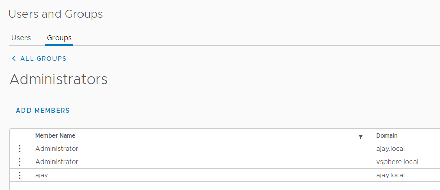

    Seems to me as user missing in a sso group  .
    2021-04-26T03:08:54.918Z [pool-6-thread-1 ERROR com.vmware.vim.vcauthenticate.servlets.AuthenticationHelper opId=] Hit ServiceFaultException while fetching admin group for the SSO Admin user
    : Administrator@ironrising.com
    Check if above account(Administrator@ironrising.com) is present  in Administrators and SystemConfiguration.Administrators
  • 9.  RE: VCSA no healthy upstream and services failing to start
    Posted Apr 27, 2021 03:58 AM
    AJ,
    How do I check that if I can't access vcenter?   I checked vCenter Server Management and didn't see that sections (on port 5480).
  • 10.  RE: VCSA no healthy upstream and services failing to start
    Broadcom Employee
    Posted Apr 27, 2021 04:01 AM
    try to start the   vsphere-ui service and see if u can login to web-client and check it  . If not this needs a SR with VMware Support
