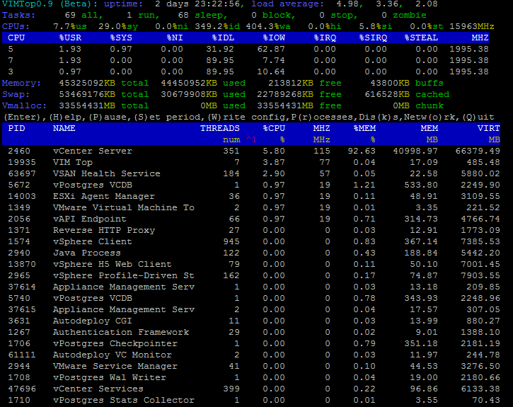

    When I look at  VIMTOP  for the vcsa ,vCenter Server is using 90% of the memory.
    How do  find out what is using all this memory ?

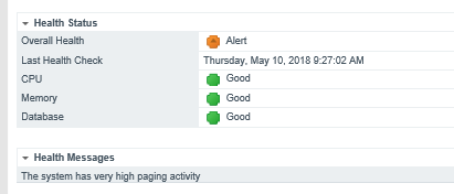

    The only alert in the vcsa mgmt UI is the memory, which has a high paging alert.
    What is using all this memory?
    This is causing the web client to bog down after a few days and makes it impossible to manage vcenter or Horizon.

    2) your postgressql is not behaving properly, as you can see Dynamic allocation for it is 3956, but it is already touching approx 10Gb , and it is creating a lot of
    vmware-vpostgres 3956 9858 687 206 480 435
    3) your linux kernel and vpxd is also taking out all juice of your environment, first they are not getting any memory dynamically allocated but are taking out
    LinuxKernel -1 43517 43426 0 14 2 8796093022207
    vpxd -1 42752 40897 40865 31 25 8796093022207
    If i were you, I would do the following steps
    1) follow the vcenter best practice document, for postgres and other services, there are some very good recomendations like increase initial thread pool for vpxd, putting log and some other disks on seperate luns etc
    2) I will try to create a seperate vCenter VM as per recomendations and migrate to the new vCenter( basically you need to do advanced vCSA deployment)
    2) I will try to add another vCenter vm, to existing PSC  to load balance the load on one vCenter VM or if PSC is also cramped i Will do 2vcenter 2 psc load balanced configuration as i am not currently aware of kind of I/O or size of your environment
