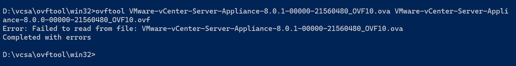

    Hi,

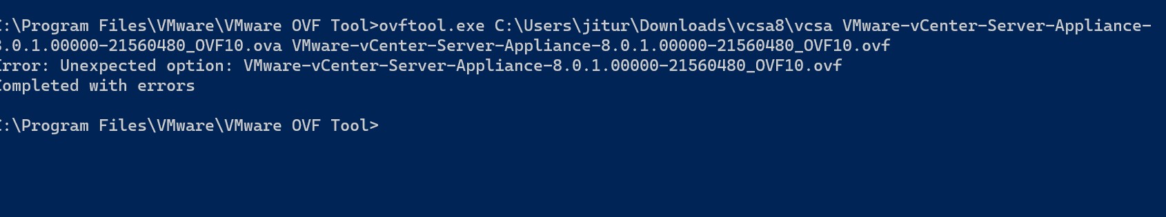

    Thank you for sharing this link. I am getting this error while running this script.ovf.jpg

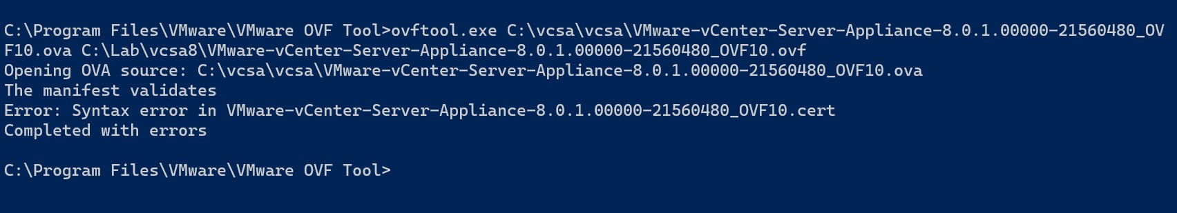

    Hi,
    Yes I have followed the same instruction but its not working. Please find the attached screenshot ovf-tool.jpg

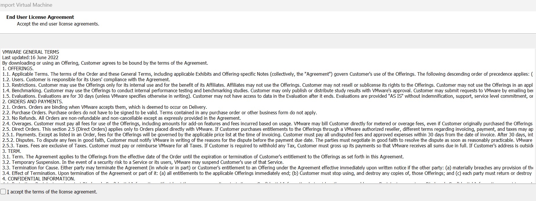

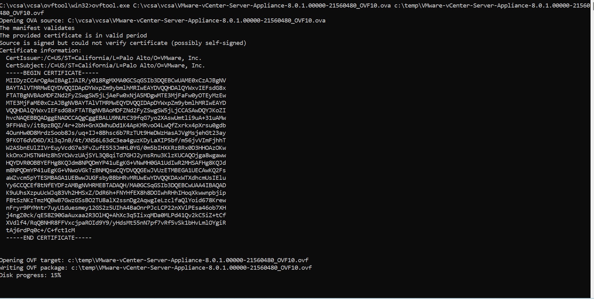

    I think now script is working but getting vcsa appliance installation screen.OVF-tool-working.jpgvcsa-install.jpg

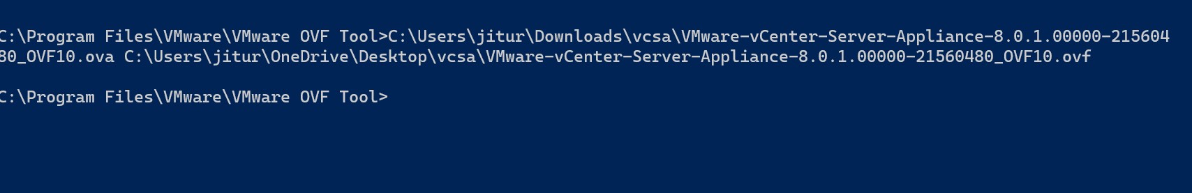

    Thanks for your response. I removed the vcsa ovf file from OneDrive. Extract the contents of the VCSA 8.0 ISO to local C drive, and tried to run the command . Now I  got different types of  error. Please let me know how to rectify this so that i can proceed with VCSA-8 installation. Waiting for your response.

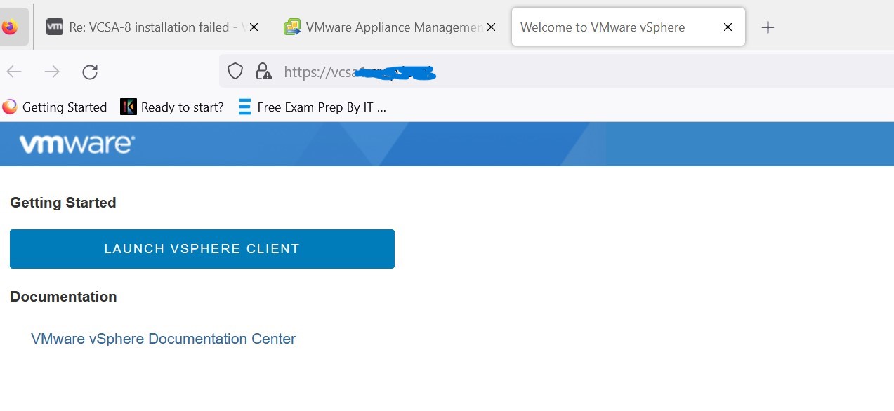

    Thanks a lot for your support. Finally after so many attempts, I have done with Step1, step 2, Step 3 and Step 4 VCSA OVA to an OVF convert done without any issue. VCSA displayed  the DCUI gray/blue screen with IP address. I proceed with the installation but instillation stuck at 84%.  Do not know what to do next. OVF-tool-convert.jpgvcsa-8-stage1 error.jpg

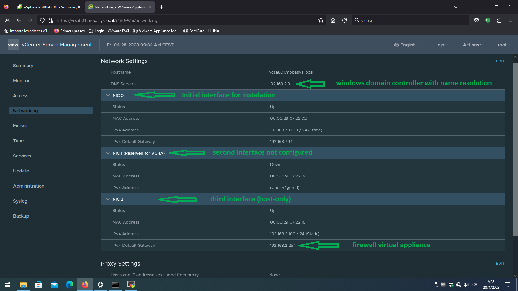

  • 14.  RE: VCSA-8 installation failed
    Posted Apr 27, 2023 05:58 PM

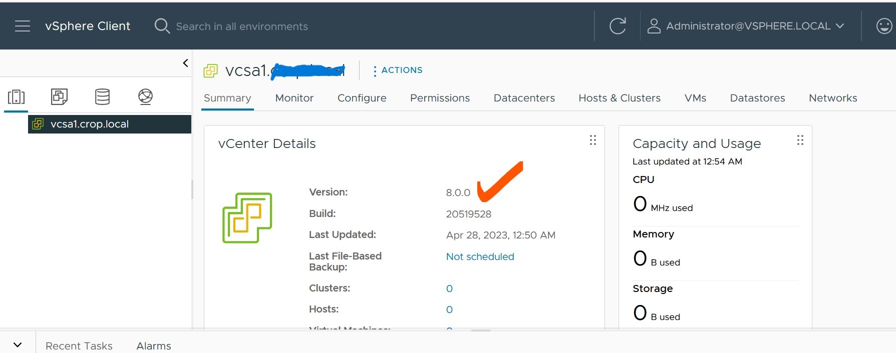

      |   view attached
    Good afternoon, I came to this thread after finding the solution to convert the file to ovf format and it didn't work either, and has refreshed my memory with version 6.7. At the time I managed to install it giving access to the internet (from what I see in the old vm with a card configured in NAT, in the current case I have configured it as a bridge, with access to the internet, but I have configured the dns and time services on the dedicated vlan on the firewall...and VOILÀ!!!! I don't remember exactly if I had to add the internal card without touching the NAT card because if it didn't fail, I'll update tomorrow. I hope it works for you.

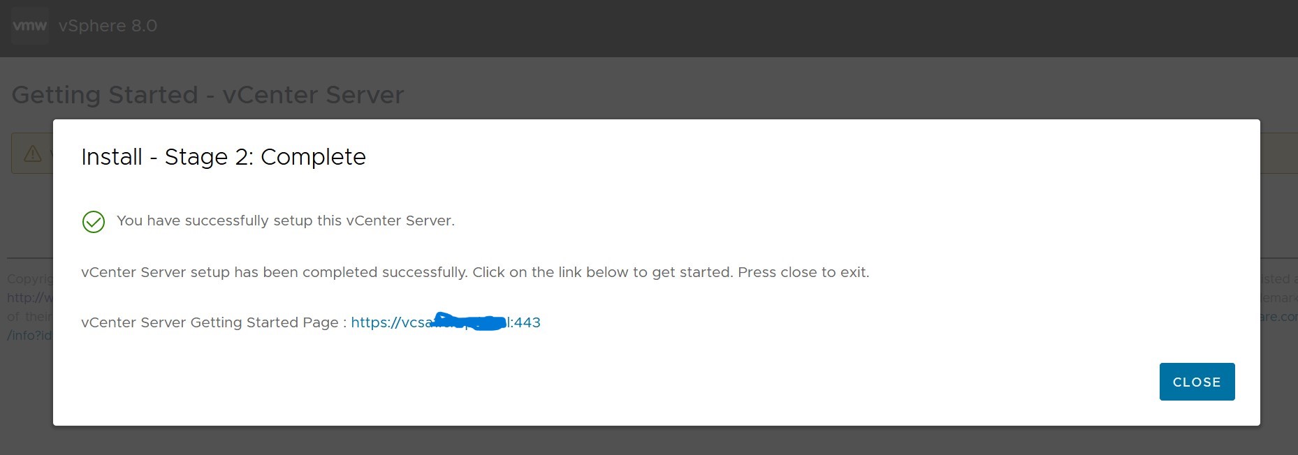

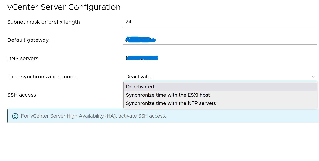

    Thank you for your valuable advice "Deploying a VCSA object is a process that needs its own time so don't be in a hurry and be patient. I will remember this line forever. Finally, I have successfully installed VCSA8 on my VMware workstation version16.This version of vcsa-8 appliance installation is taking too much time.The installation stuck at stage1 in 84%. Here we have to wait.. Once stage 1 completed, stage 2 started, earlier Time synchronization was deactivated, I selected synchronize time with ESXi host. Thank you, all of you who have participated in this thread.

  • 16.  RE: VCSA-8 installation failed
    Posted Apr 28, 2023 08:19 AM

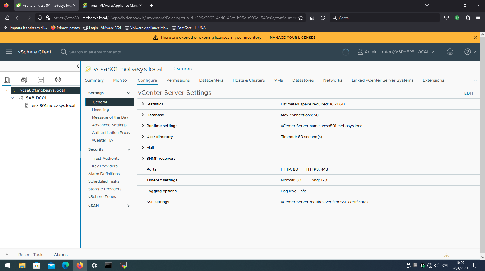

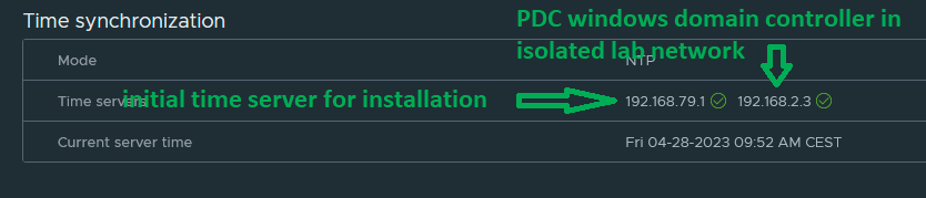

    Good morning, I tried hot add and configure a second interface (the installation appliance mark to reserved for HA) and it has stopped working. After reverting the snapshot I have added again the second interface that the appliance reserves for HA and I have not configured it. I've added a third internal card (Host-only) and configured it with my private lab network configuration, and configured with my windows domain controller for dns resolution, firewall virtual appliance for gateway and time server against the PDC:
    I access from the two networks without problems, and I have added the esxi with name resolution.
    I will try later to disable the bridged interface, as in my old installations of version 6.7, to see if it doesn't stop working. I want to configure the Internet access only through the virtual appliance of the laboratory.
    With this method, stage 2 ends in five minutes, in one of the many trys I have waited more than 3 hours in the 84% part and it has not finished.
    I hope it helps you.
    grettings
