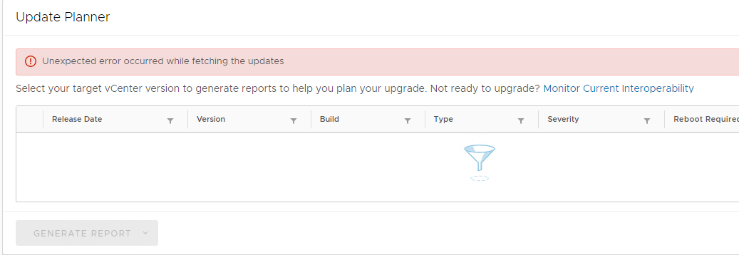

  • 1.  VCSA 7.0 - Update Planner "Unexpected error occurred while fetching the updates"
    Posted Aug 03, 2020 10:09 PM
    I am getting this error message for VCSA 7.0 - Update Planner "Unexpected error occurred while fetching the updates"

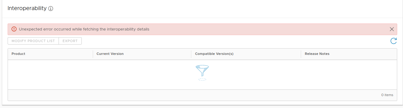

    Also getting errors under "Interoperability" - Unexpected error occurred while fetching the interoperability details

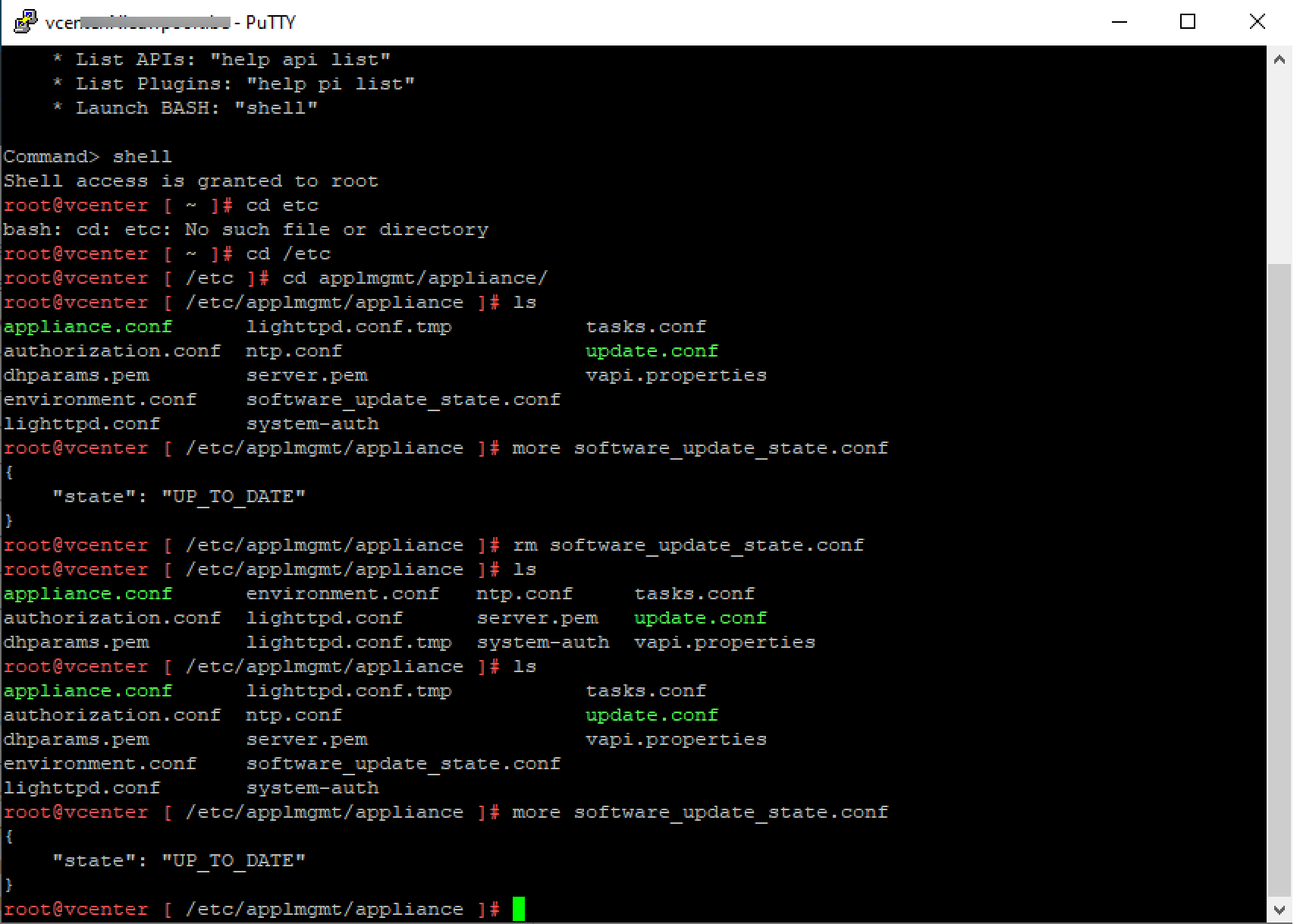

    I have tried:
    "SSH into VCSA 7.0 and run the below command:
    rm /etc/applmgmt/appliance/software_update_state.conf
    After removing the file, VCSA patched successfully."

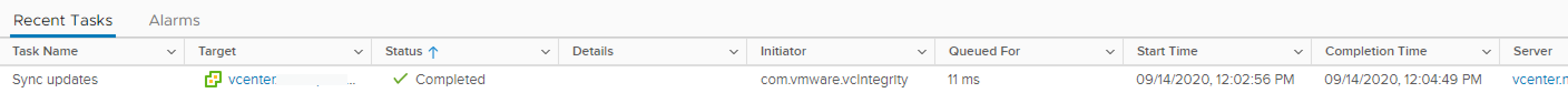

  • 6.  RE: VCSA 7.0 - Update Planner "Unexpected error occurred while fetching the updates"
    Posted Aug 03, 2020 11:18 PM

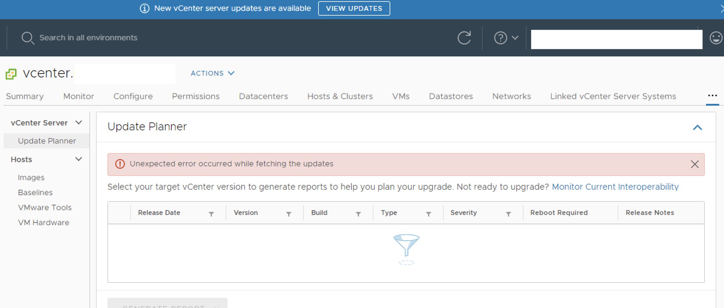

    Some Screenshots of the errors

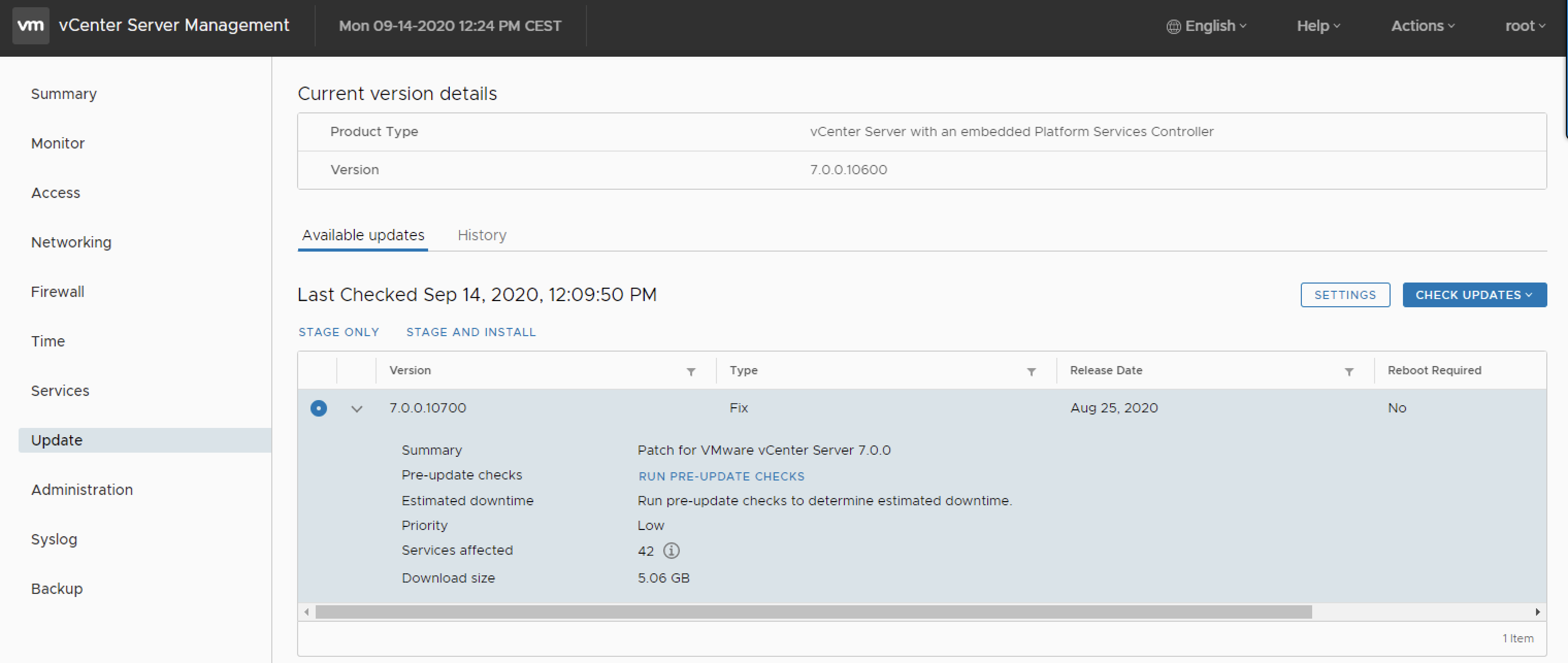

    Are you seeing the same issue if you try to update through VAMI? If so could you tail /var/log/vmware/applmgmt/software-packages.log when you check for updates?
  • 11.  RE: VCSA 7.0 - Update Planner "Unexpected error occurred while fetching the updates"
    Posted Aug 17, 2020 02:37 PM
    Not sure about OP, but this error shows up in VAMI...
    I'm shooting for a reinstall this week. Just starting with VMware lab past month. I'd like to see if this is something I did or an actual VMware error, so I can well not repeat the mistake.
    Error in method invocation [Errno 2] No such file or directory: '/storage/core/software-update/updates/index'
    Spoke to soon, hit check for updates a few times and now it shows up. Doing the install now, we'll see if this works.

    Strangely I can update and patch VIA VAMI, I see no issues there.

    It seems the error for Interoperability and updates still exists, although it appears to have updated from Vami.

    This is from the release notes under known issues:
    When you use the Update Planner, in the vSphere Client you might see Unexpected error occurred while fetching the updates
    When you use Update Planner, which is part of vSphere Lifecycle Manager, used to facilitate vCenter Server updates, you might see the following error in the vSphere Client:
    The issue occurs when you use a custom HTTPS port that prevents you from running interoperability reports by using the vSphere Client.
    Workaround: Manually invoke the API. For more details, see the vSphere Automation API.
    Although I do not use a custom port, it could still be revelant? I have also not figured out how to manually invoke the API.

    The /etc/applmgmt/appliance/software_update_state.conf file however shows "UP_TO_DATE"
    After removing the file /etc/applmgmt/appliance/software_update_state.conf it is recreated and still shows "UP_TO_DATE"

    VAMI shows that an update is available

    I pass the update 7.0.1.00200 to 7.0.1.00300
    shell
    renew the update scan, download update, apply update.
    Wait long minute in dark, no progression view in VCSA Console, but the update pass in background.
    We can see in syslog in ssh some mouvement operation.
    VCSA restart, and you are un 7.0.1.00300 !
    tested in non-production environnement, for observing the stability before apply in production

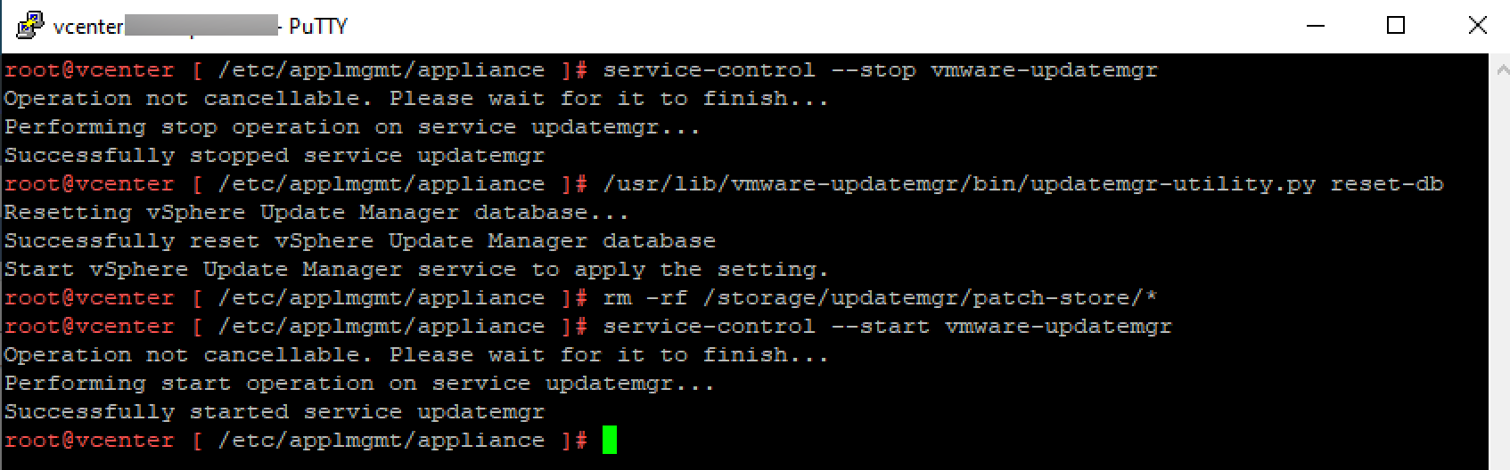

    I had and still have the same issue with updates.
    the only thing that solves the problem is as described and im sending just the commands to ease the process for someone that stumbles uppon this issue.
    cd /etc/applmgmt/appliance/
    rm -rf software_update_state.conf
    service-control --stop vmware-updatemgr
    /usr/lib/vmware-updatemgr/bin/updatemgr-utility.py reset-db
    rm -rf /storage/updatemgr/patch-store/*
    service-control --start vmware-updatemgr
    after soo many updates the issue is still not resolved.

    Is this a workaround for this version or a fix?
  • 34.  RE: VCSA 7.0 - Update Planner "Unexpected error occurred while fetching the updates"
    Posted Oct 04, 2021 03:10 PM
    Hi,
    this is a workaround. Sadly you have to do this for every update.

    root@dr-vcsa [ /etc/applmgmt/appliance ]# rm -rf software_update_state.conf
    root@dr-vcsa [ /etc/applmgmt/appliance ]# service-control --stop vmware-updatemgr
    Operation not cancellable. Please wait for it to finish...
    Performing stop operation on service updatemgr...
    Successfully stopped service updatemgr
    root@dr-vcsa [ /etc/applmgmt/appliance ]# /usr/lib/vmware-updatemgr/bin/updatemgr-utility.py reset-db
    Resetting vSphere Update Manager database...
    Successfully reset vSphere Update Manager database
    Start vSphere Update Manager service to apply the setting.
    root@dr-vcsa [ /etc/applmgmt/appliance ]# rm -rf /storage/updatemgr/patch-store/*
    root@dr-vcsa [ /etc/applmgmt/appliance ]# service-control --start vmware-updatemgr
    Performing start operation on service updatemgr...
    Successfully started service updatemgr
    Still see: Unexpected error occurred while fetching the updates - under update tab on vcsa.
    Am i missing something here?
  • 36.  RE: VCSA 7.0 - Update Planner "Unexpected error occurred while fetching the updates"
    Posted Oct 05, 2021 10:12 AM
    Afterr those commands you have to start the update from https://"your_vcenter_address:5480/#/login" without rebooting VcenterServer.
    It should show you the update available for your vcenter.
    Remember to upgrade from https://"your_vcenter_address:5480/#/login" after you run his commands.  Worked perfectly.
