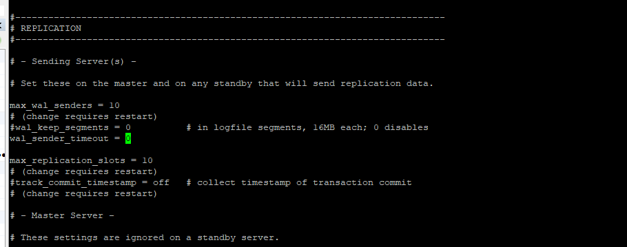

    This service seems to change to status "stopped" every once in a while. I searched the KB and found a tip to change the wal_sender_timeout parameter to 600s, so the service doesn't run into any timeouts, but sadly this didn't help. I tried setting wal_sender_timeout to 0 (disabling the timeout), bu the issue still persists.

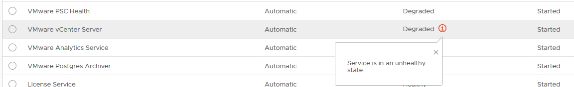

    VMware PSC Health & VMware vCenter Server:
    Both of these services currently show up as "degraded":

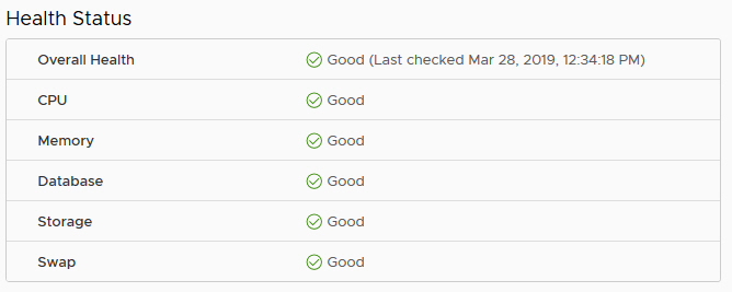

    Meanwhile the summary page reports everything as "good":

    Quick update, it seems like the services PSC Health and vCenter Server both switched back to "Healthy", but the Postgres Archiver changed to stopped again. Very curious...

    We have vCenter Appliance 6.7 Update 2a (6.7.0.31000) and confirmed that wal_sender_timeout settings are already set to 600s as default during the installation. Also, upgraded to vCenter Appliance 6.7 Update 3 (6.7.0.40000) but Postgres Archiver service keep shutting down.

    Yep, exactly the same issue here - running latest VCSA and still getting the postgres archiver service stopping (confirmed that the timeout is set to 600ms in the config with this version of the VCSA).
