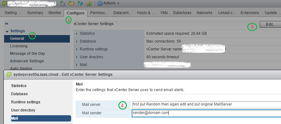

    Hi,
    It's known bug in VCSA 6.5, quick resolution what I applied is - redefining the mail server @ vCenter settings and it’s Done :smileyhappy:
    Steps:
      1. Open the Web Client
      2. Click on vCenter (Left Pane) -> Select the Config tab -> General Settings -> Click Edit -> Mail Server
      3. Modify the Mail server to any Random IP/FQDN and click OK to save.
      4. Again go to edit and put the actual Mail server IP/FQDN and click OK to save.
      5. Enjoy the Alerts ! :smileyhappy:
