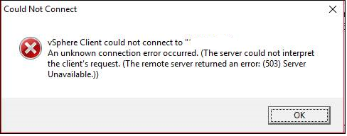

    Yesterday we tried ‘resetting’ the vcenter server from one of our virtual hosts.  We watched the server reboot and did notice an error that the embedded database had failed to start along with a few other errors which may have referenced some services not starting (although it was hard to keep up with the fast scrolling screen).  When we try to logon using the client we get the error below connecting from the client software:

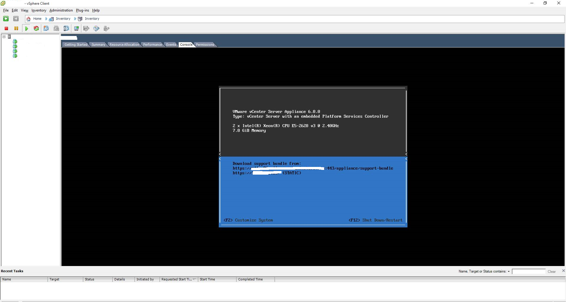

    We can see the server logon screen when we connect from the host:

    You should check VCSA's FQDN is resolving successfully from the client you are accessing, and its services status. If you can't check services then a reboot should reproduce this issue.
    See the very first symptom : "503 service unavailable" error when connecting to vSphere Web Client (2121043) | VMware KB

    Should I attempt to reboot again? This was done yesterday evening which is when the 503 error prompted.
