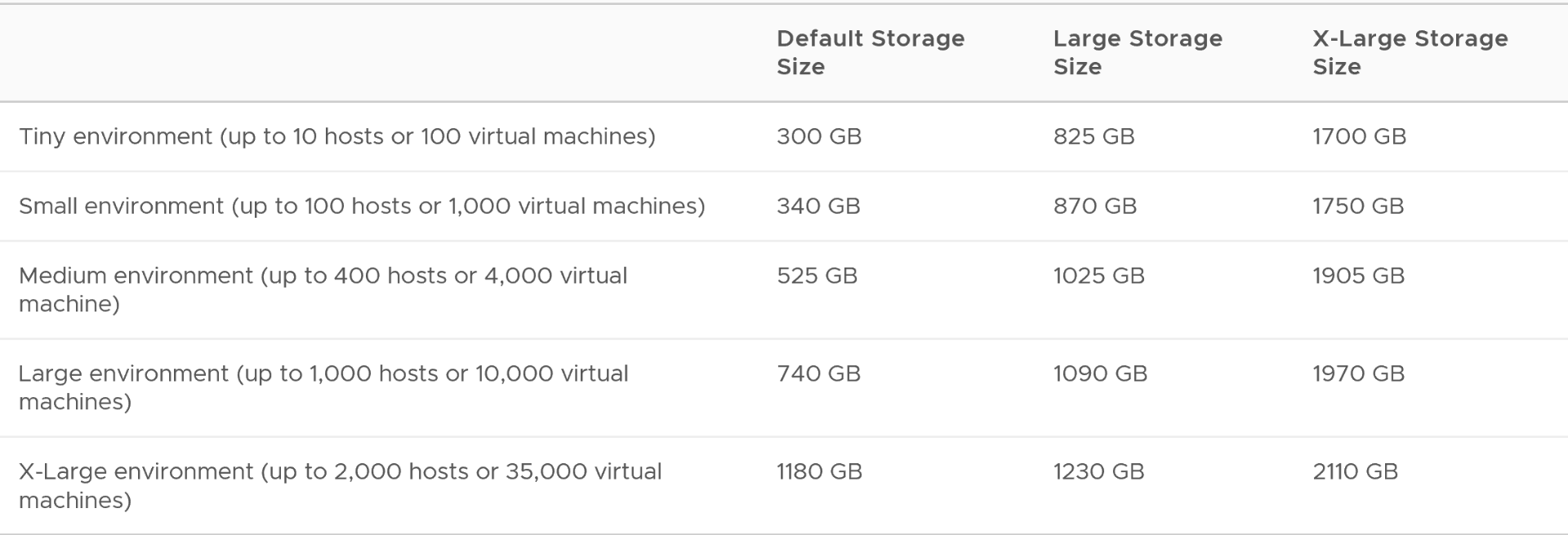

    while you decide the size of the vCenter, take a look also at Storage Requirements:
    Storage Requirements for the vCenter Server Appliance and Platform Services Controller Appliance

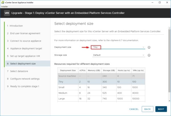

    can we get the below same screen when I upgrade my vcenter so that we can pick from drop down and select some other size?

  • 5.  RE: vCenter size changing
    Posted Aug 21, 2019 03:13 AM
    Well, I think the sizing options and drop downs [tiny, small, medium, large and so on] are shown only initially, also this setting will not save or cached in any of config file.
    but if I am not wrong if you are upgrading VC using ISO image you will see the same screen again and can able to change the size settings as per your growth

    Posted Aug 21, 2019 05:02 AM
    Hi,
    You can only see the screen in your image if you update the vCenter. If instead you want to increase the size of the vCenter you have to follow the second link 'Resize down the road"
    Update vcenter screens:
    vSphere 6.7 aggiornare vCSA 6.5 a 6.7 - pt.2 • Nolabnoparty
    enter the dimensions you prefer (this is an example):
    Resize down the road:
    Increase Disk Space On VCSA 6.5: It's Not as Difficult as You Think
    Alesandro Romeo
