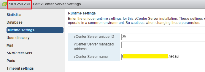

    I have a vCenter appliance which I have inherited and upgraded from 6.0 to 6.5. When I view the vCenter configuration from vCenter - vCenter Servers - Configuration - Edit, I get the hostname and FQDN displayed in different areas.

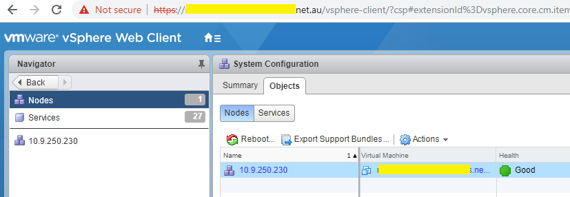

    Similarly from Home - System Configuration - Nodes, I see the vCenter as an IP not the FQDN.
    I noticed that the certificate is issued to the common name '10.9.250.230' rather than the hostname.

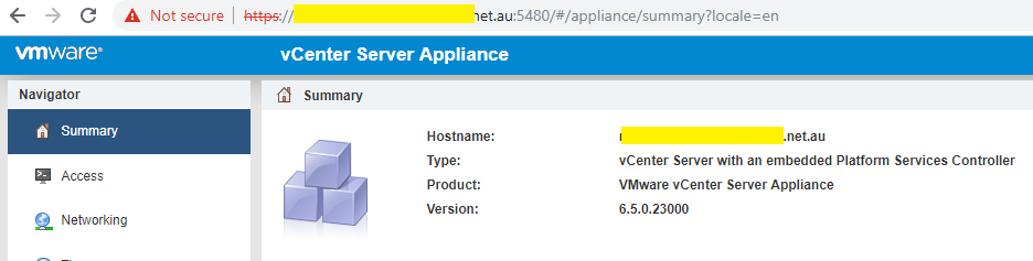

    The VAMI interface also shows the correct FQDN
