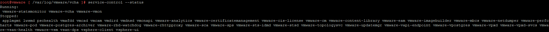

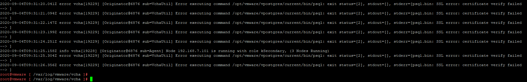

    Mi vCenter HA (that worked fine until 3 days ago) is not working anymore and I get the error:
    If I SSH to passive node, I get the following:
    cat /var/log/vmware/vcha/vcha.log
    service-control --status
    it seems there is an SSL issue.
    I was using custom SSL certificates, but during troubleshooting, I could reset all the certificate from the certificate-manager (option 4), and setup again vCenter HA with self signed and VMCA certificates, but the same issue occurs.
    Anyone has any ideas, of faced the same issue in the past?
    I can attach more logs, if needed.
    Thanks anyway for the support.
