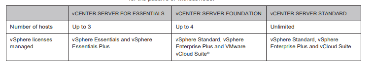

    https://www.vmware.com/content/dam/digitalmarketing/vmware/en/pdf/products/vsphere/vmware-vsphere-pricing-whitepaper.pdf
    vCenter Server is available in the following packages:
    • vCenter Server for Essentials – Integrated management for vSphere Essentials Kits.
    • vCenterServer Foundation –Powerful management tool for smaller environments
    looking to rapidly provision, monitor and controlVMs.
    • vCenter Server Standard – Highly scalable management with rapid provisioning,
    monitoring, orchestration and control of all VMs in a vSphere environment. vCenter
    ServerHighAvailabilitydoesnotrequire a separate vCenterServerStandard license
    for the passive or witness node.
    then you have two possibilities:
    - buy the vCenter Server Foundation license and keep the standard ESXi licenses you have
    - check the possibility of transforming ESXi Standard licenses into vSphere Essential Plus (where you have included the vCenter Server for Essentials)
