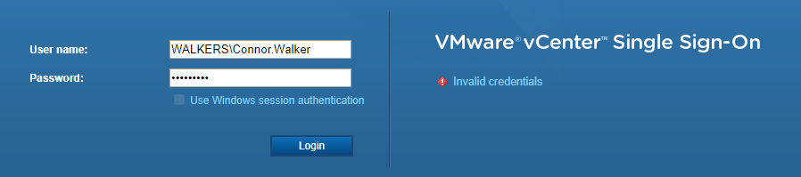

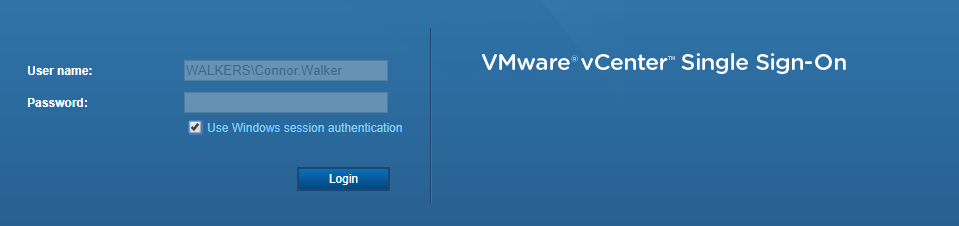

    When i click Use Windows Session Authentication it auto fills the username and logs me in:
    This is what it says when i input the username and password manually:

    Posted Mar 08, 2020 07:14 PM
    Tried this and it just says "Invalid credentials"
