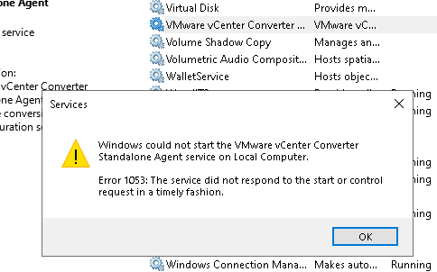

    hi all,

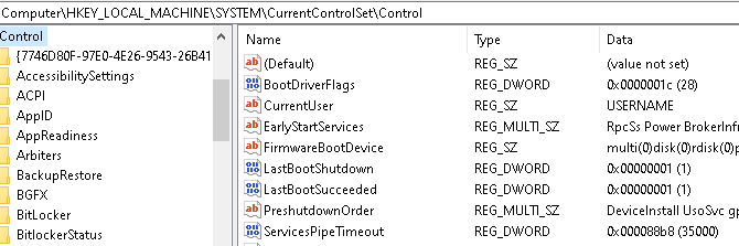

    so im in the process of migrating my vms of xen to vcenter and so far so good on the linux machines, but windows im getting stuck
    i have installed the vcenter convertor agent on the local machine and its installed but i cant get it to start in the services (see pic)
    so i then changed this in the reg
    also
    thanks,
    rob

  • 4.  RE: vcenter convertor agent - wont start, error 1053
    Posted Feb 24, 2020 03:57 PM
    ive done that in my last screenshot but it doesnt work

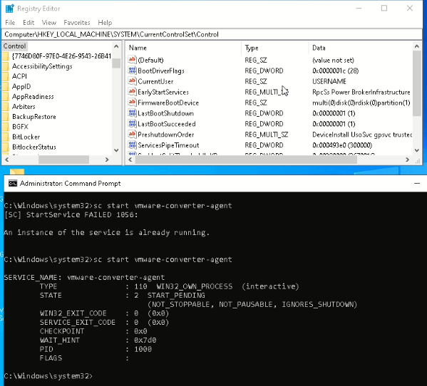

    On your image ServicesPipeTimeout is 35000 which is far behind 300000 (~10 times), also you need to reboot Windows in order to take effect.
    You can run service in elevated command prompt, by removing parameter '-s' from command line of the Agent service. Can you share results of such execution? Keep in mind that Agent must be run as service in order to execute privileged commands for conversion.

    Posted Feb 25, 2020 08:30 PM
    ok its now running but im still having same problem, ie permission is denied on the vcenter converter pc

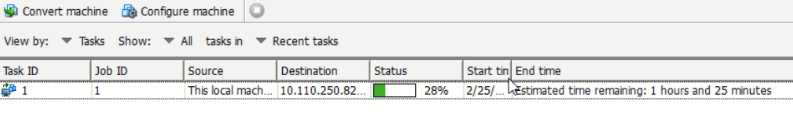

    right, i have done it another way, installed vcenter standalone converter locally on the source vm and its working
  • 11.  RE: vcenter convertor agent - wont start, error 1053
    Posted Feb 25, 2020 10:18 PM
    great so it worked

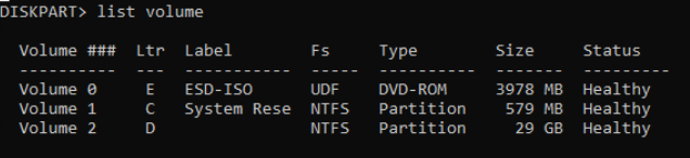

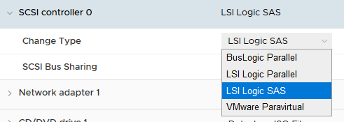

    ok so i booted windows and went to recovery mode and started cmd, did a -
    chkdsk D: /r
    found no problems on the windows partition
    do you think i need to change the SCSI controller to another one ie -

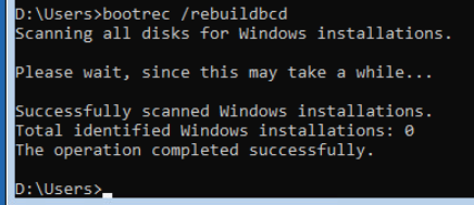

  • 14.  RE: vcenter convertor agent - wont start, error 1053
    Broadcom Employee
    Posted Feb 26, 2020 01:13 PM
    You probably need to run bootrec/rebuildbcd in recovery mode. see https://support.microsoft.com/en-us/help/927392/use-bootrec-exe-in-the-windows-re-to-troubleshoot-startup-issues
    You need to change the controller type *before* conversion in appropriate disk-tab.

    i will probably choose SATA
  • 16.  RE: vcenter convertor agent - wont start, error 1053
    Broadcom Employee
    Posted Feb 26, 2020 03:22 PM
    More or less this depends on the guest OS (available drivers, ability to attach/move disk(s) to controller, etc), however you can try it.

    Posted Feb 26, 2020 04:21 PM
    cant find my windows installation but when i do a dir of d:\Users, i can see all my users on the pc, so i dont know why it cant find any windows installations?
