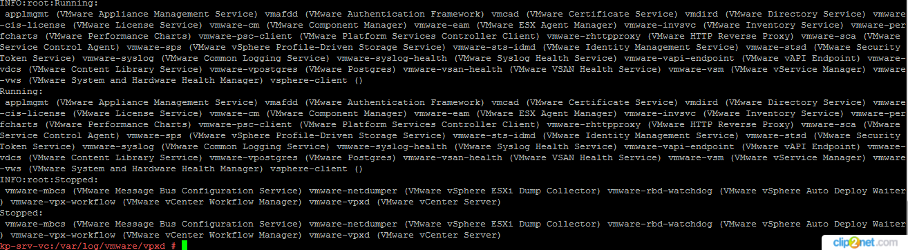

  • 5.  RE: VCenter Appliance VPXD service does not Start with Error
    Posted Jan 28, 2019 08:23 PM
    A number of services except vmware-vpxd are not running, try to start everything one by one?
