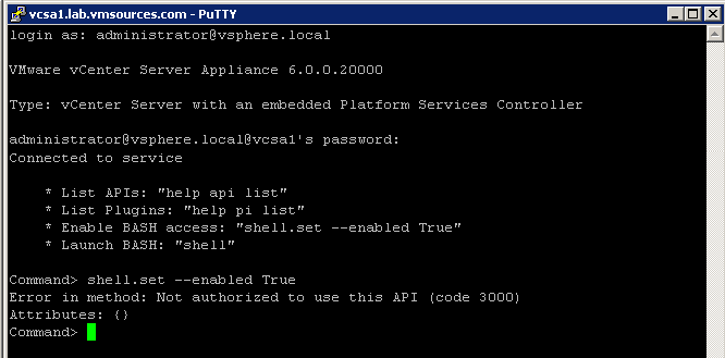

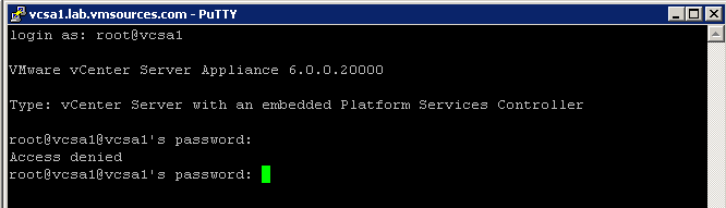

    The login for vcsa using ssh is: root  (not root@localos -see the last screenshot)
    administrator@ssodomain.tld (administrator@vsphere.local) will not work as it is not authorized to use the API:
    And here's what happens when you use: root@localos
