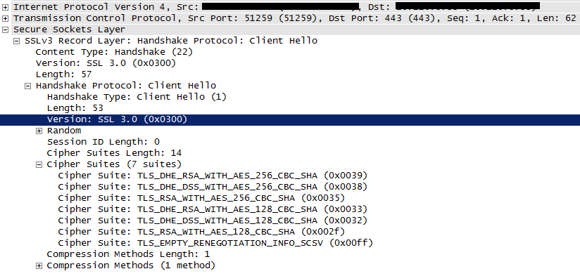

    I can confirm that vCenter 5.5 (U2) communicates with hosts (5.5 U2) via SSLv3 only, the reason being vCenter only supporting SSLv3 in its initial SSL Client Hello packet when connecting to an ESXi host::
    Note: The SSL/TLS communication socket between vCenter and vpxa agents on hosts is always initiated from the vCenter vpxa.exe process acting as the Client connecting to port 443 of a host and not vice versa (what protocols vCenter supports on port 443 is irrelevant).

    I suspect configuration changes have to be made to the vCenter Java application so the Client sends a TLS version in the handshake Hello. When I lanuch the Java control panel on the vCenter via the command below I can see that SSLv3 and TLSv1 are supposedly enabled, but the handshake Client Hello sent by vCenter to the Client is SSLv3 only:
